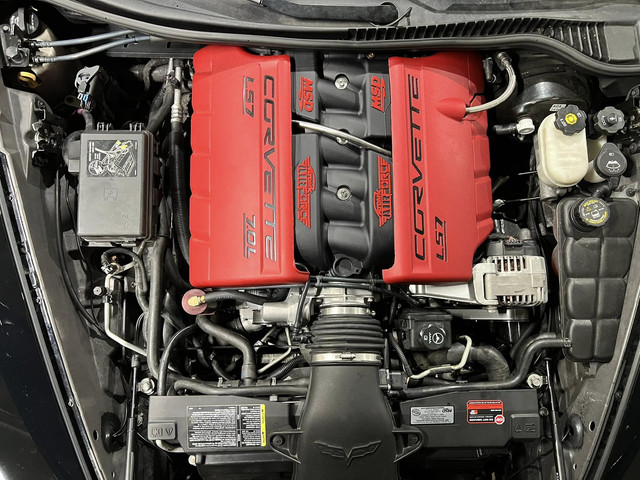

And here's the next. Usually consistency is a good thing but here, ... oh my. Here's another LS7 doing LS7 things. This one had 18k miles on the odometer when the exhaust valve left the chat:

So this one we get to put back together in a way that does the Z06 some real justice. The LS7 is out of production today. It is getting harder and harder to source this engine or it's components. This build will focus on retaining the LS7's bore and stroke but will use aftermarket components to achieve that. This build will consist of a Dart SHP block, Brodix BR7 cylinder heads, Cam Motion stage 3 camshaft, Johnson 2110R lifters, PAC springs, ARP hardware, and an all forged rotating assembly with I beam rods, 7cc aluminum pistons, and 4340 crankshaft. It's even getting the Katech C5R timing chain. Here is part 1 of the build..
