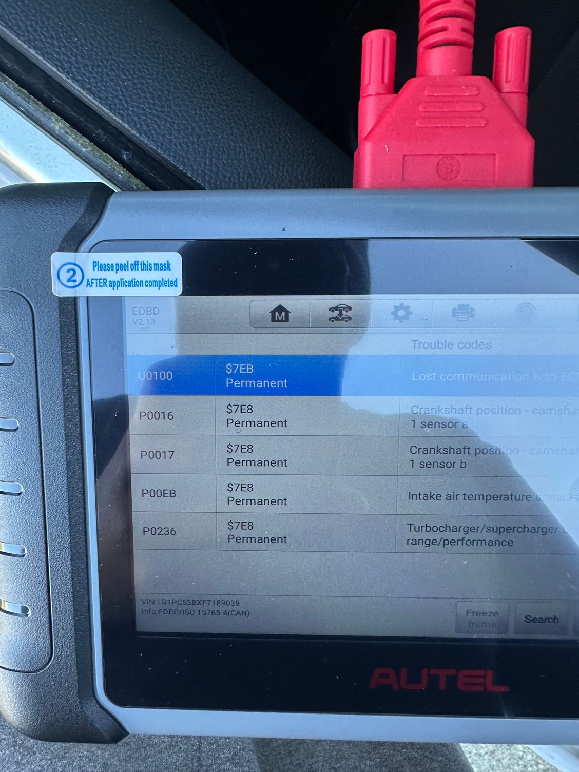

Hi there,
I have 2015 chevy cruze which cranks over but doesnt start. If starts it is very rough nd dies after couple of seconds.
Engine codes are
U0100
P0016
P0017
P00eb
P0236.
I already checked all the grounds. I tried to hook jump cables with other battery but no luck.
new spark plugs
new coil pack
new turbo boost sensor.
Does anybody dealt with this issue.

The most common problem with these engines is oil consumption. The cam-crank correlation codes (P0016/17) are almost always indicative of low oil level and/or overdue oil change, so start by making sure the oil level is correct. With the engine cold, it should cover 1/2 - 3/4 of the cross-hatch “safe” area on the dipstick.
The MAF code (which I’m guessing is actually P00BE) and boost sensor code (P0236) can both be set due to the cam-crank correlation.
For the U0100, see if there’s a 2 digit sub-code (U0100-xx) to get more specific info on why the code set.
