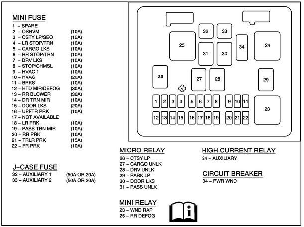

not sure if this is it or not, '04 is pretty vague, but worth a shot,

Whatever those relays are, I don't think it's them...
I've got power all over in my under hood fuse panel with key out, and after cycling the doors. Cycling the ignition triggers fuel pump, dash lights, etc normally, but key off i've got 1.7 amps of unknown draw...
Ideas? Thankyou.
