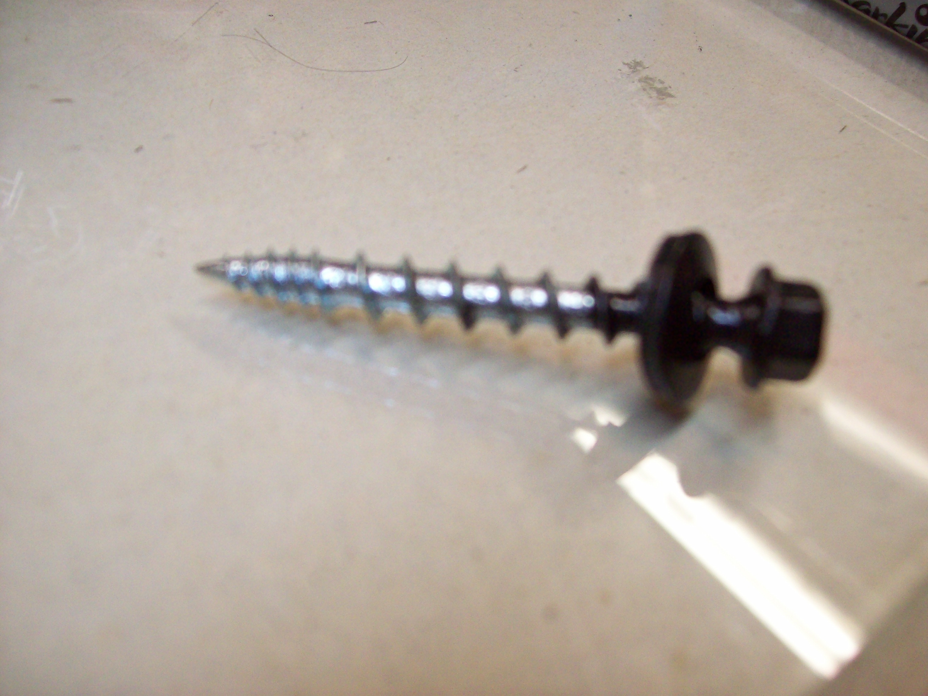

Here is my 2 cents.... this is a sheet metal screw that roofers install when a person wants metal roof instead of shingles...
( how do I know this ) well I have a box of them still left over from my patio porch lol which I installed....on my 40x20 roof....
point is I drilled a small 1/8th in pilot hole and used my drill gun to install I Have No leaks any were on my roof.... I know you
can get these screws at lowes or home depot which ever is your choice ... heck I will even say menards prolly has them too....lol
But point being... this is a rout I will take if I ever have that problem on my van... Sure you could go as far as adding some
silicone as well for added protecting.. if your real **** you could even add some paint to the pre hole you drill... but point being
it would be a cheap easy fix... and in my opinion not leak.. ( My Roof Doesnt ) and its in direct rain fall .....
