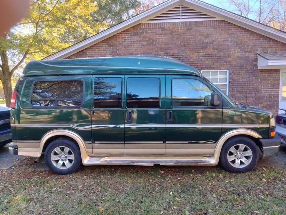

6 lug wheels on my Savanna 1500.
I thought the express an Savanna vans came w/ 5 lug wheels?
the seller was actely in the tire business, he told me that these wheels have been upgraded w/ GM made aluminum 17". so am I mistaken that the 1500s normaly have 5 lug 16" wheels?
I'd like to have 2 spare aluminim wheels (don't care if they match current wheels) will any GM 6 lug wheel like from a truck or even a SUV fit? I do like the Trailblazer or Saab97x wheels but will settle for whats available. please advice an thanks

I would look for something rated for the weight so likely from a 1500 Silverado or Suburban.

As far as I know all the modern 1500s have 6 lug wheels and they're the same pattern as the trucks and full size SUV's with 6 lug. The offset might be different so the wheels might ride farther inside or outside of the fender.

All the GM 1/2T vans switched to 6x5.5” bolt pattern in 2003, even the Astro/Safari series.
