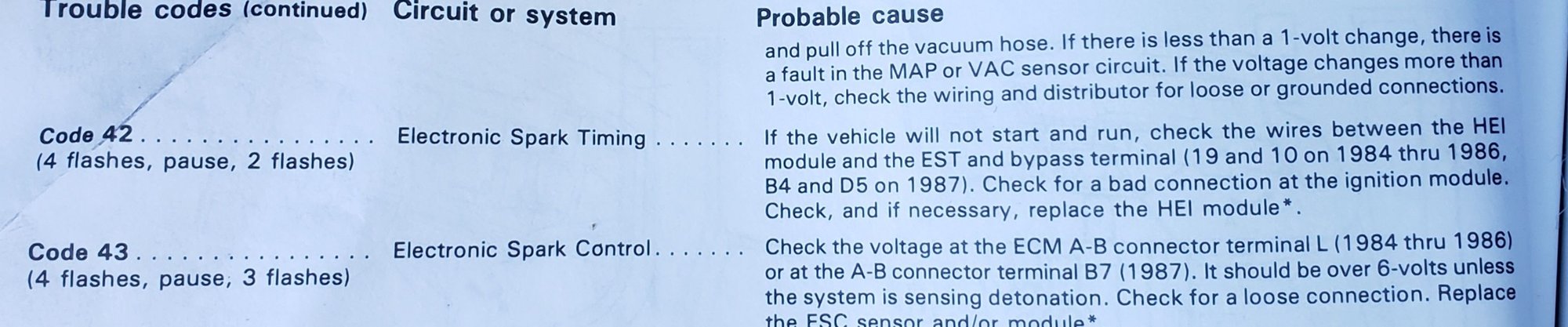

From here, I changed the Idle Air Control Valve, and topped off coolant. Check engine light came on around this point and threw a code 42 which the manual says is 'Electronic Spark Timing'. I checked the connections between the ICM and the ECM with a multimeter for continuity while stress testing the cable as best as I could and it seemed to be able to pass signal. Did the same for the pigtail from the ICM to the coil and the cable/connector seems fine.
