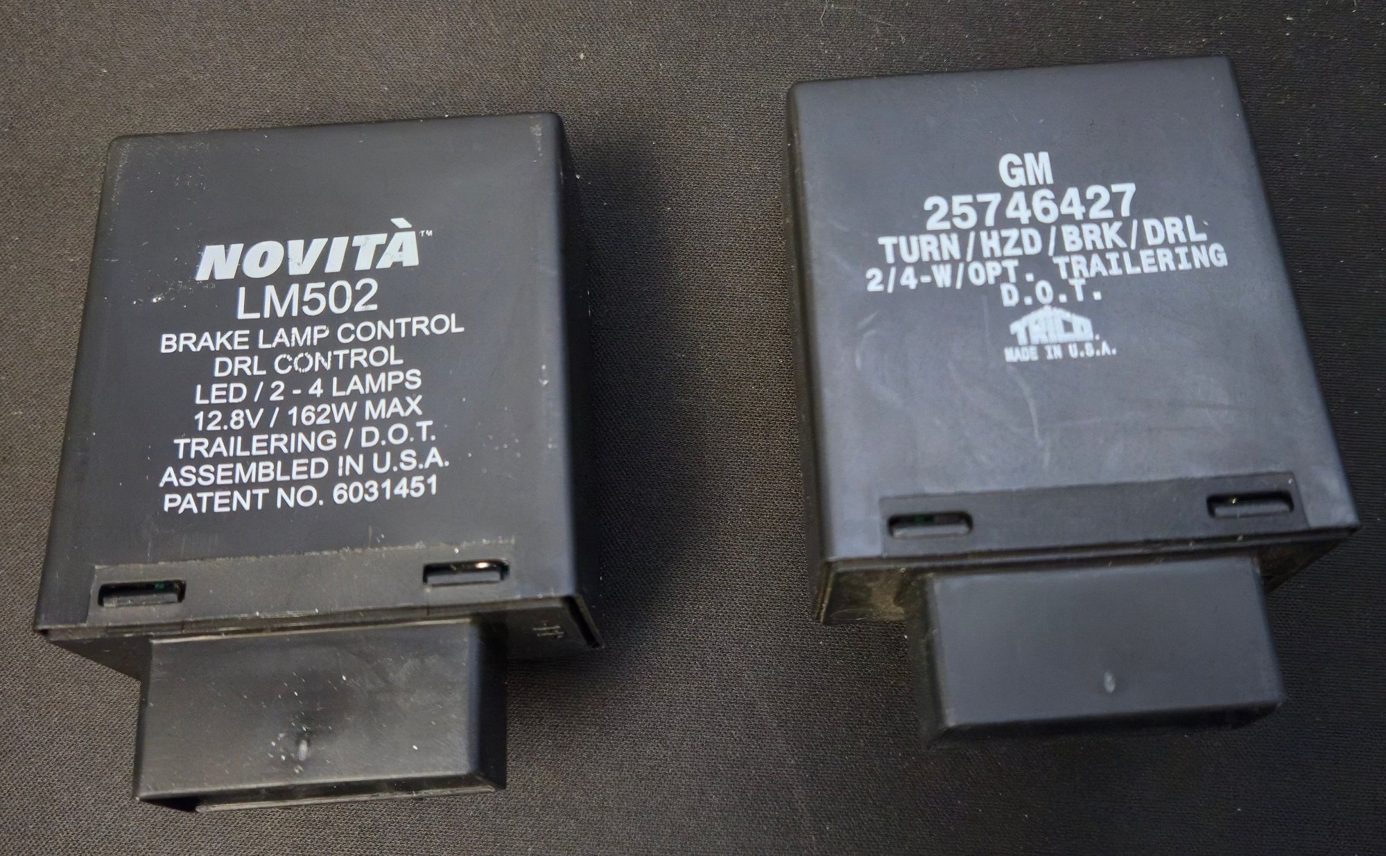

2003 GMC Savana, put in all LED blinkers and now I have hyperflash which doesn't really bother me but I'm curious is anyone has found an after market replacement for the GM 25746427 light controller that will resolve it. The original part goes between $60-$120 as I've seen it so I wonder if it's worth bothering with.

Just so people know what part I'm talking about

I think I found what I'm looking for, the NOVITA LM502:
https://www.rockauto.com/en/moreinfo...=10139&jsn=652
It's currently going for $50.79 on Rockauto (for reference)

I just installed the recommended resistors to solve the led hyperflash

Solved. Just a matter of unplugging one and plugging in the other. Here is the needed device with the original for reference:
