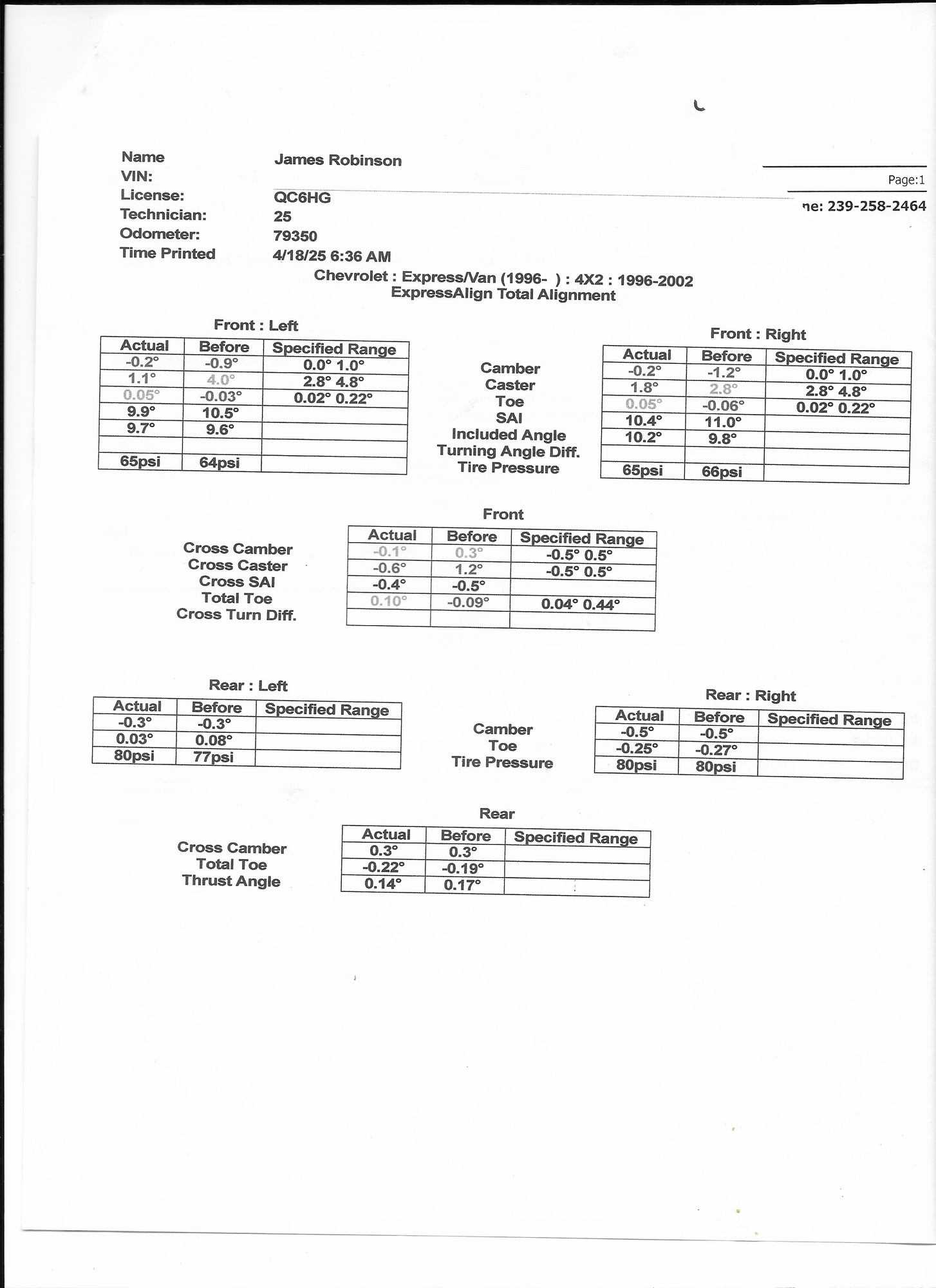

I added the specs first and then it would not allow me to enter text. I have had a wandering issue with a 01 Chevy express 3500 Cut away single rear wheels. I have done a fair amount of work to it, new leaf springs, coil springs in front, control arm bushings, tie rod ends, ball joints, idler arms and brackets etc. It has the caster camber kit. Brand new ACDelco lower ball joint was bad!
Are these spec's acceptable cause it sure does not feel right?
