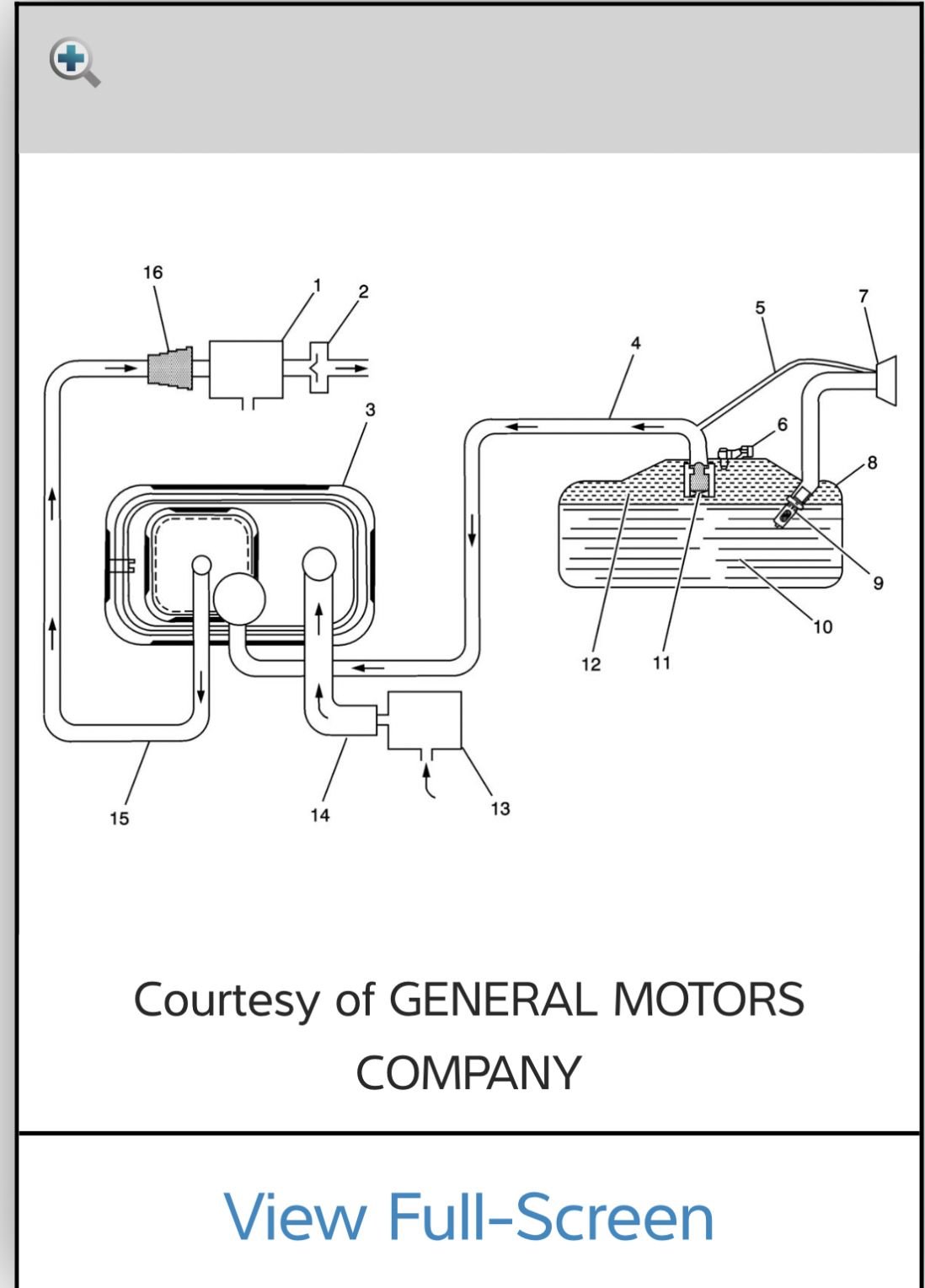

Below is an illustration of the EVAP system. It’s not exactly like yours but it’s the same basic concept/operation.
Parts are as follows:
2) Purge valve
3) Canister
13) Vent valve

allright thanks all, I got the diagram and that is what I figured. I am almost thinking it would be worth a shot to shoot compressed air through the line that connects up to the charcoal cannister. Any blockage would go into the fuel tank. I know this isn't ideal, but it would only makes sense the blockage would be somewhere else and probably in that line. it might only take a quick blast, and voila, problem solved.

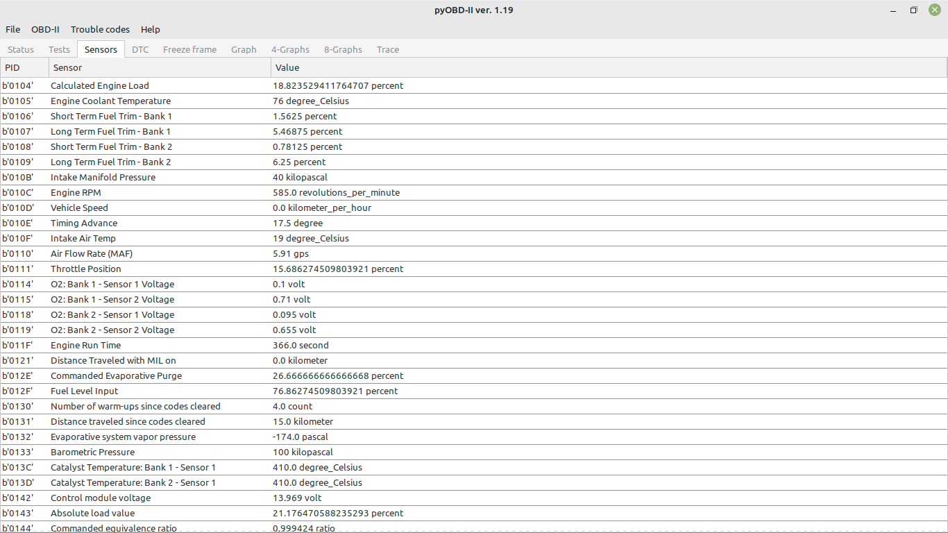

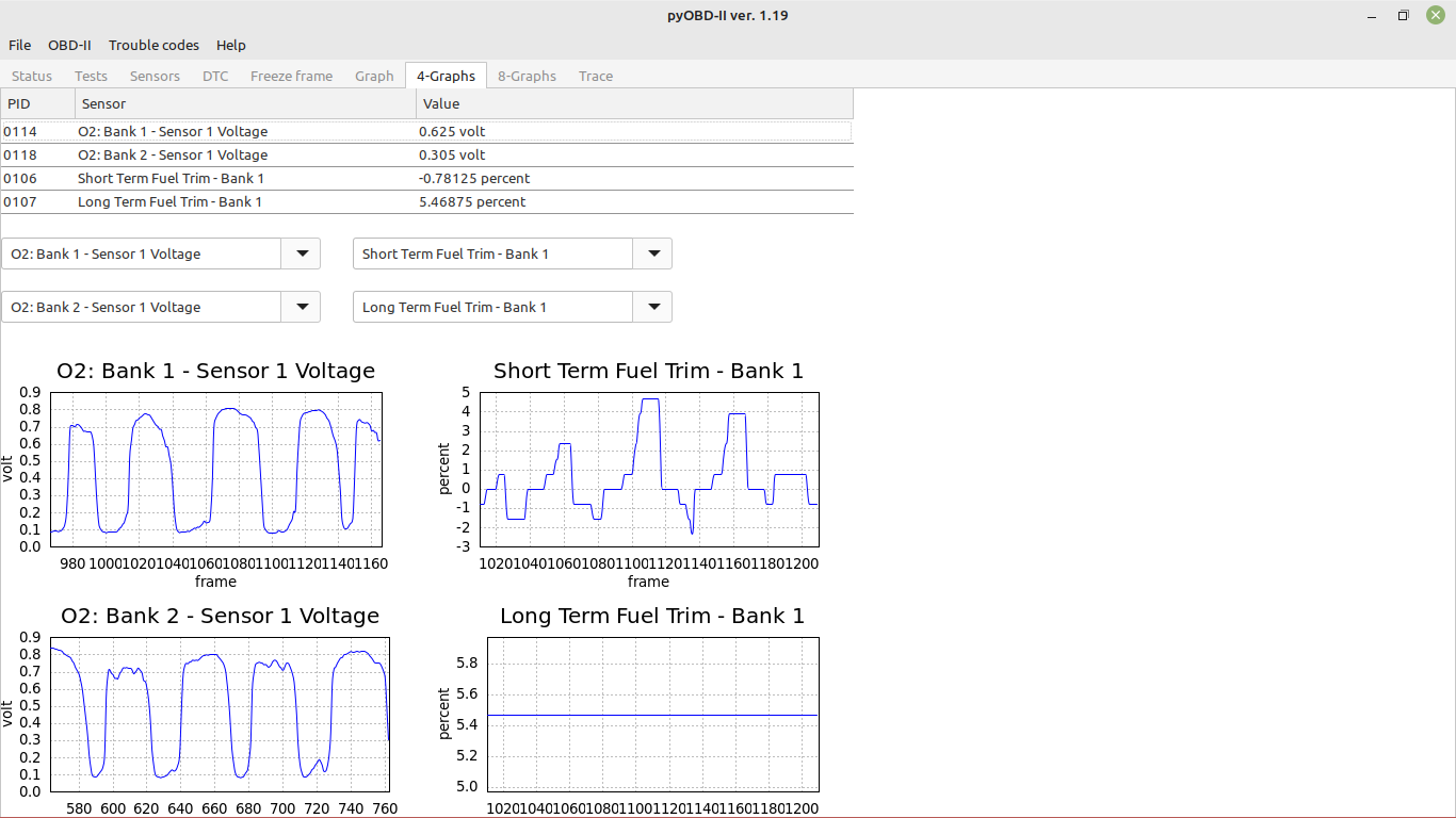

I was back at testing the system. It was really easy for me to access the purge solenoid so I tested it. I disconnected the end that connects to the charcoal cannister and ran the vehicle. I did this when the vehicle was cold. I went and felt the solenoid for vaccuum and there was none. I allowed the vehicle to get to operating temperature. Then I went back to feel for vaccuum from the purge solenoid and it was strong and there, a steady on off pulse of vaccum. So that rules out the purge solenoid. I also went underneath and sprayed soapy water on all connectors for the evap system, as well as the fuel lines I could see, while the vehicle was running. I did not see any bubbles escaping. I believe the fuel tank should be pressurized quite a bit more than 1 PSI when it is running correct? In any case I was also capturing live DATA from the OBD2 system with my $30 tool. I believe this data is correct but take it with a grain of salt. I also just cleared all my codes before when I was changing the water pump, because I ran the system before installing the fan shroud and didn't have the air intake completely assembled so it threw an error codes for the MAF sensor since it wasn't detecting air flow. I just wanted to make sure there were no leaks before the PITA job of putting in the shroud and potentially gouging my new chinese radiator fins. Anyways, oddly enough when I disconnected the purge valve from the system no MIL was thrown up. not sure if that is a red flag or not. I might just replace the vent solenoid because it's so cheap, and the lines to it were filled with grey, it's old and maybe the filter has just had enough. I also have no way to know if it's partially clogged or not.
Anyways, can any of you guys help me make sense of this DATA? what are the values suppose to be for the express? ALSO REMEMBER I JUST CLEARED THE CODES SO LTFB might not be correct, which would mean the STFB would be thrown off. Correct?
And yeah I am thinking about getting the cheap smoke machine, but still worried it won't do a lick of good since the leak might be so small, and it could possibly be coming from the fuel pump area in all honestly. That is the one area I cannot see.

anybody have any idea about what I posted above? I went underneath the vehicle with a small mirror to find the fuel pump assy. it is near the front of the tank no? I went underneath with the vehicle running to see if it was a pin hole leak there, but I couldn't see any fuel leaking out. good thing it was a cold start because my arms were touching the exhaust lol.
