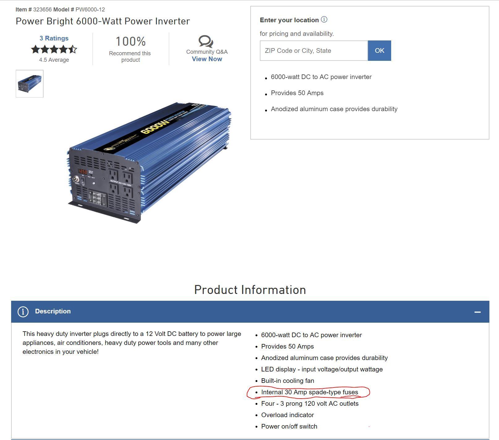

The 4000 watt inverter I looked up said the input line was protected by a 30 amp fuse.
Show me because that makes no sense.

My bad, Joe. It was a 6000 watt inverter;
https://www.lowes.com/pd/Power-Brigh...verter/3125915
You'll see in the specs that it puts out a constant 50 amps, but has 30 amp internal fuse
Dan, seems to me a small generator would do better for you. I don't know what kind of tools you use, but most tools don't draw that kind of power. My shop tools don't draw anywhere near 4000 watts. Maybe collectively, but I can only use one at a time. A welder could use that much.
No worries. The powerbright website has some more info about it
https://www.powerbright.com/product/pw6000-12
Unfortunately the spec sheet link is broken, but the manual has some useful stuff ... It's worth a look.
I didn't find any more info about the fuses like how many there are or how they're being used ... I dunno.
What I do know is that I hate fuses and having to replace them. I would try to find a device that uses circuit breakers instead.
They do say "PowerBrightTM recommends installing one ANL type fuse and fuse holder close to the positive battery bank terminal"
If you looks up ANL fuses they're huge. They're designed for 100's of amps.
