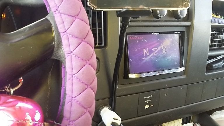

What head unit do you have, Carguy?
Old Dec 21, 2018 | 2:42 PM
  #20
carguy5280's Avatar
Joined: Mar 2018
Posts: 16
Hey Stan,
I have a Pioneer AVH-4201NEX, it's been about three years now and I still love it!
I was looking at Alpines' but they were more expensive and I liked the user interface better on the Pioneer.
One thing is that when it gets cold the touchscreen is not responsive (but the remote still works) so it takes like 5 minutes to warm up
in the winter. The camera views still work and display, just that any adjustments can't be made until it heats up a bit.
it is more purple in reality
It is a sharp looking screen, nice and vibrant.
