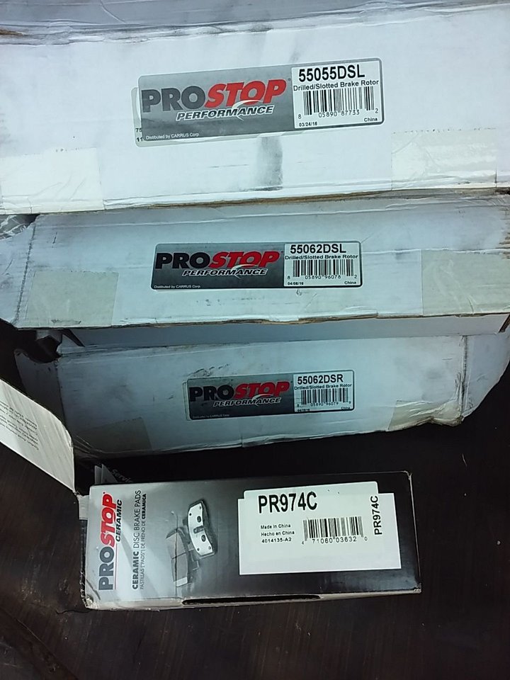

OK checked my older pics these are the reordered rotors I believe plus ceramic pads for front, you dont need it for rear, you can go cheaper for rear.

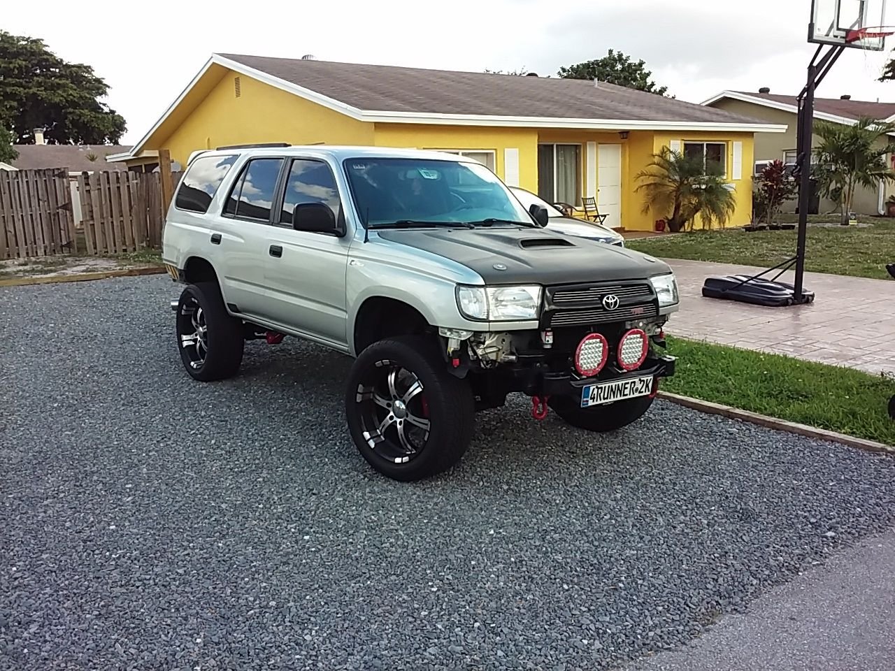

Plus my real project )) 4runner with Supra twin turbo in it, Van was just for fun.

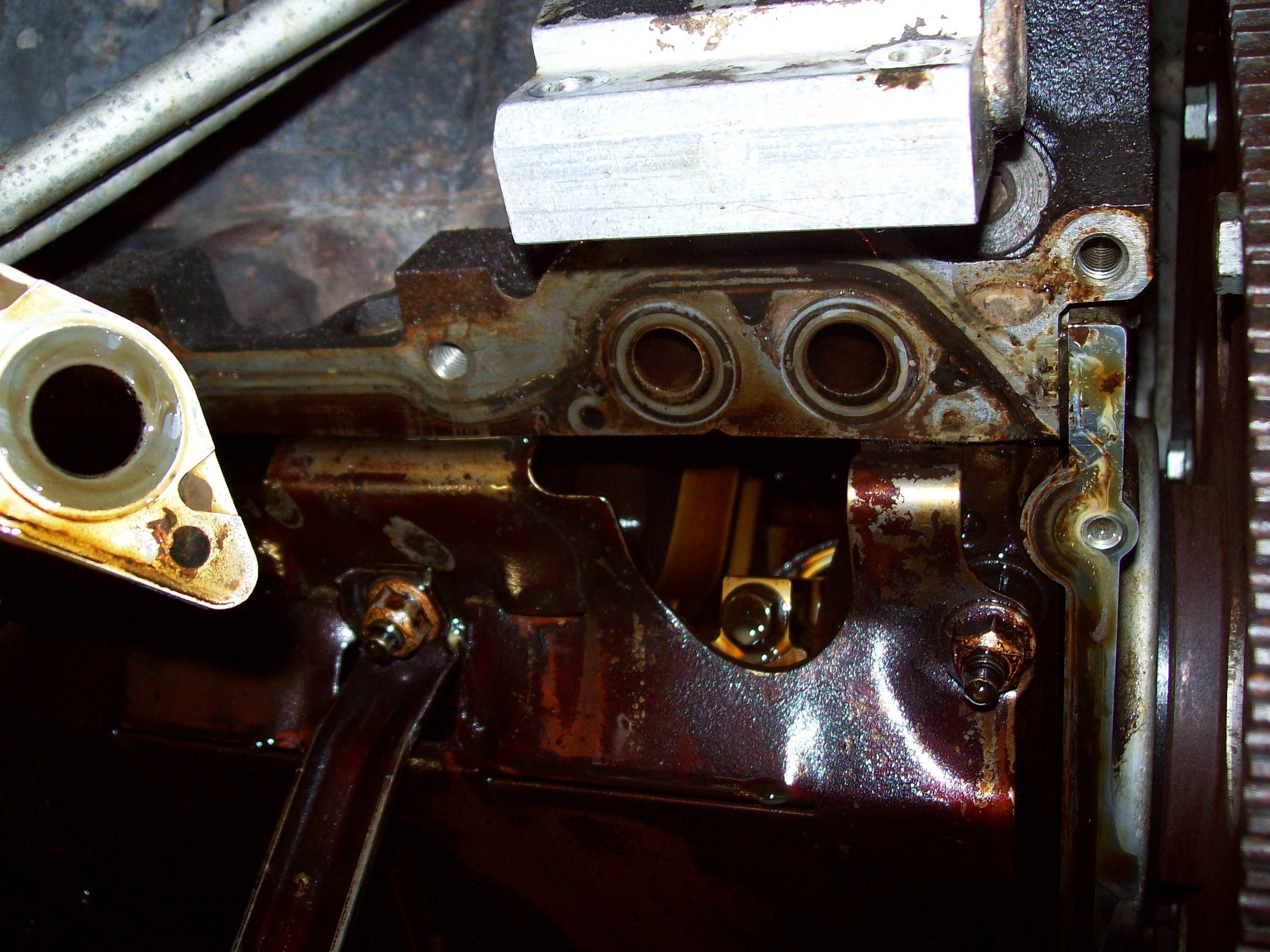

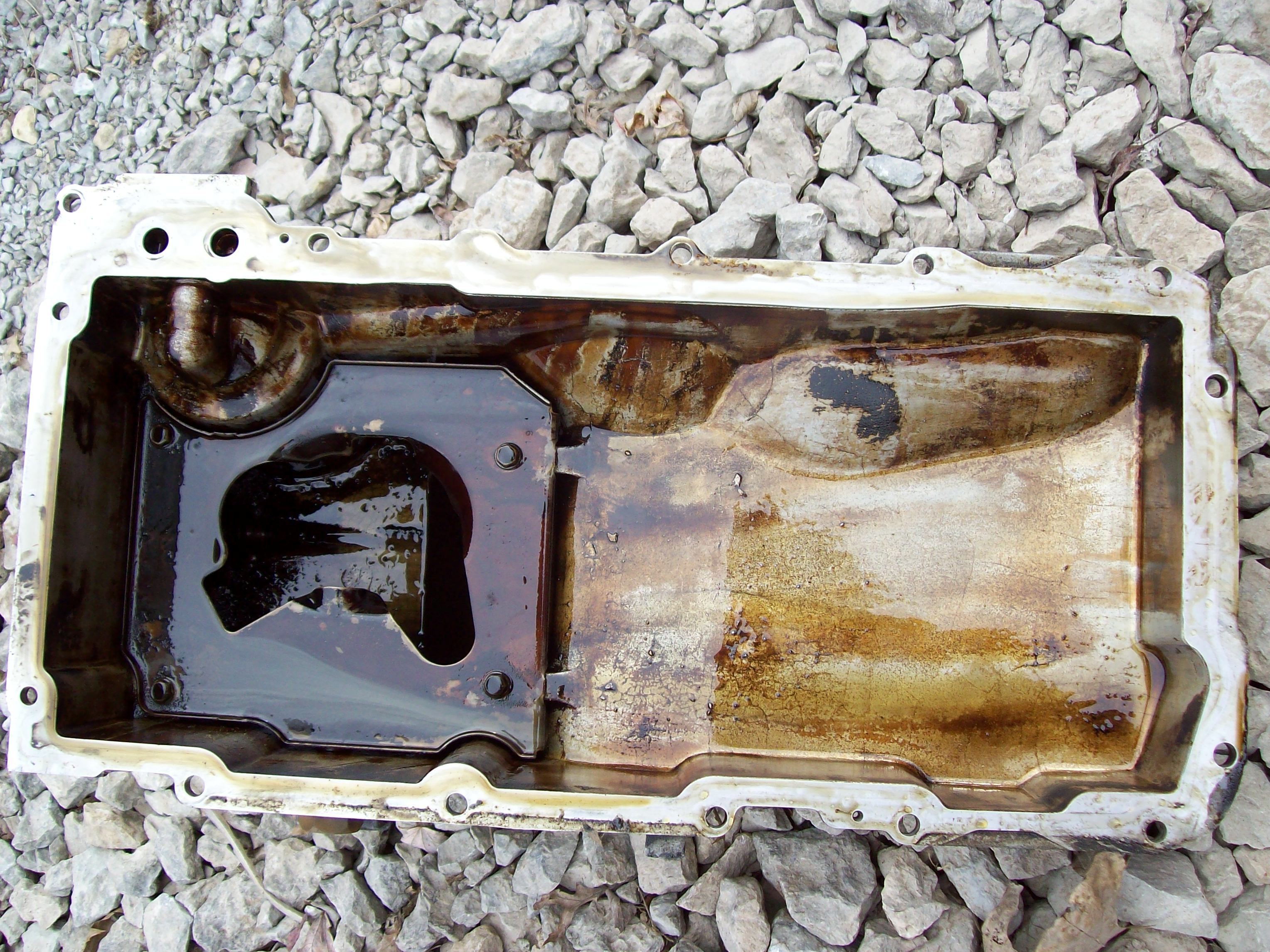

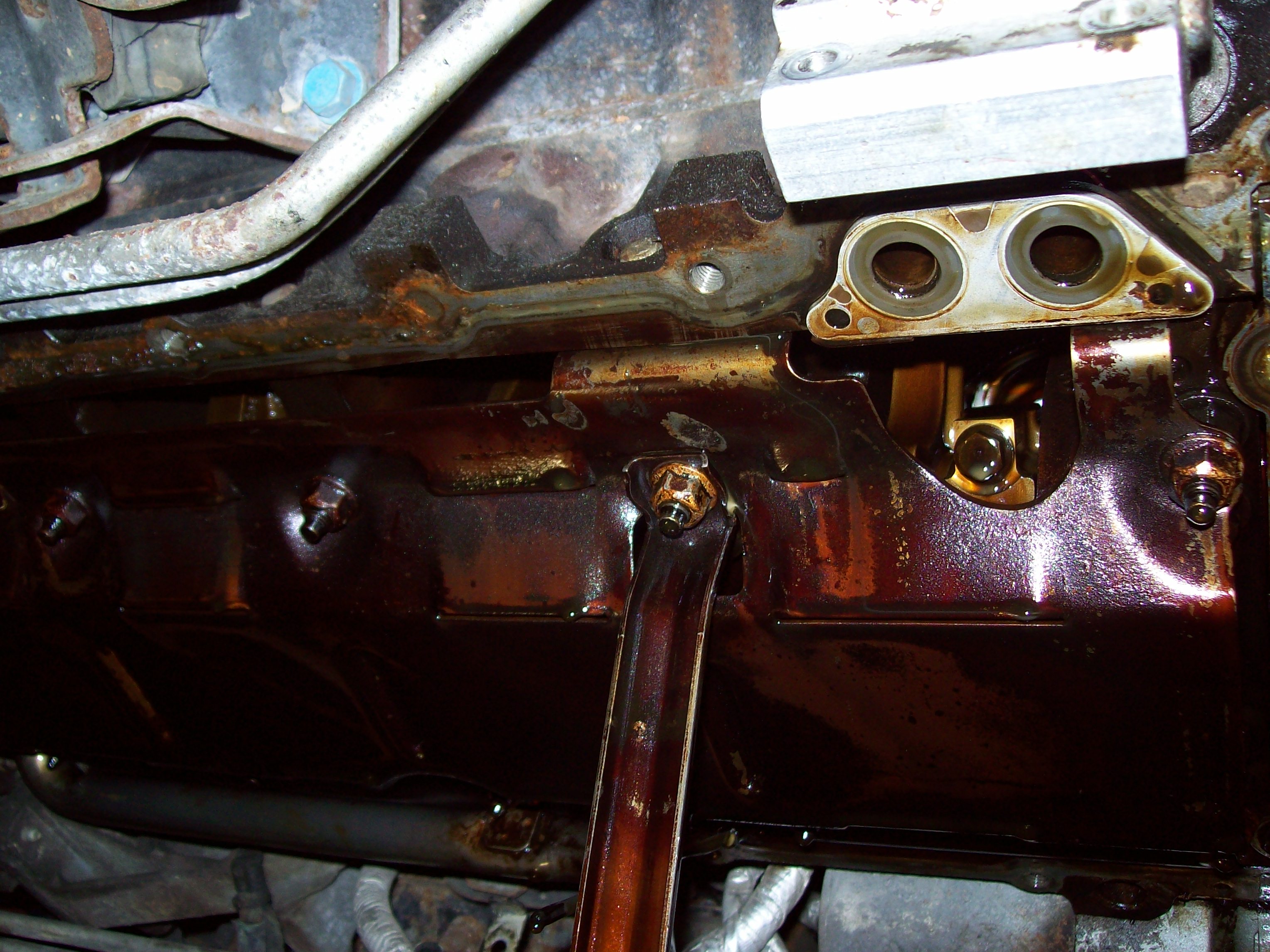

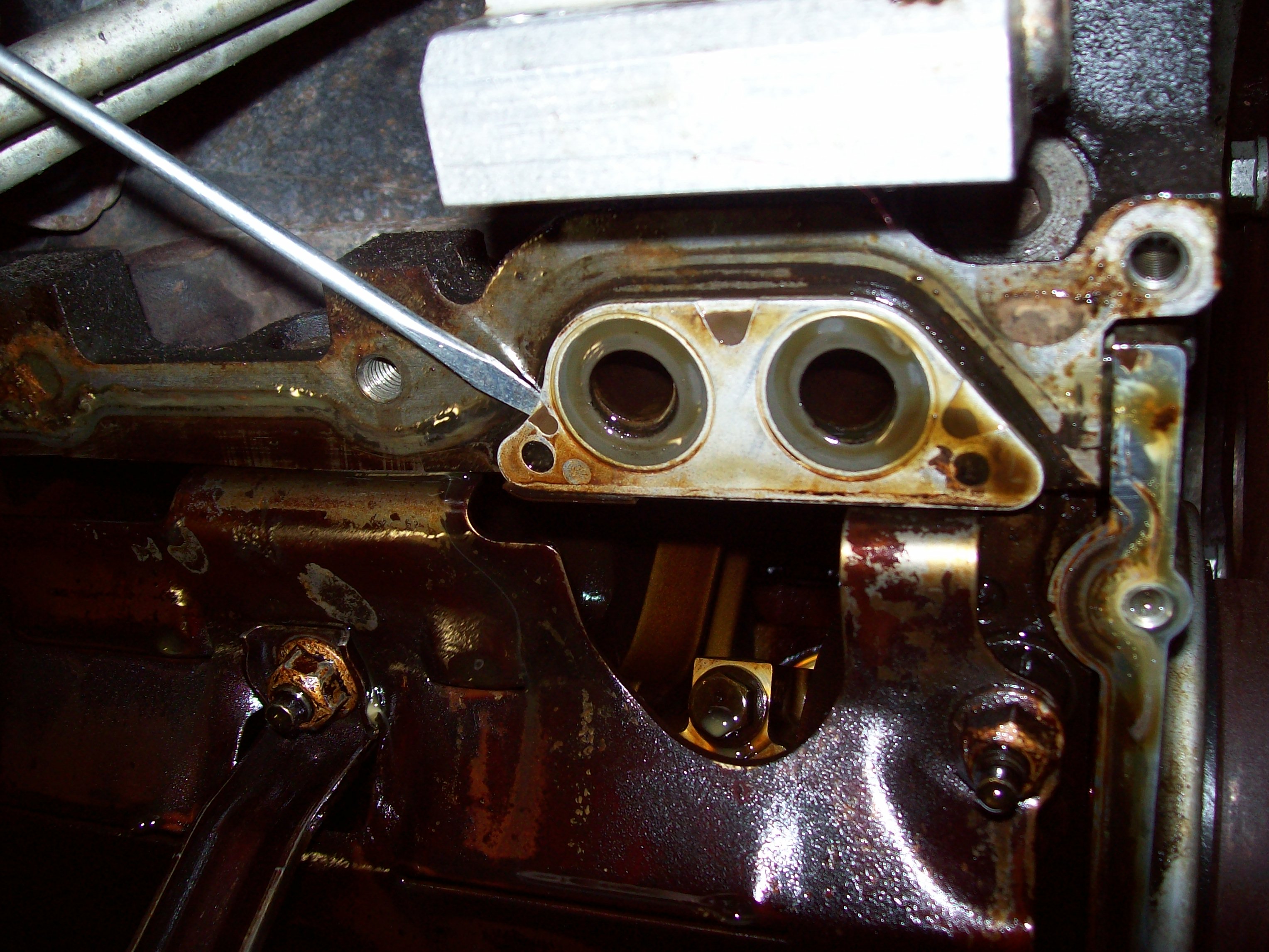

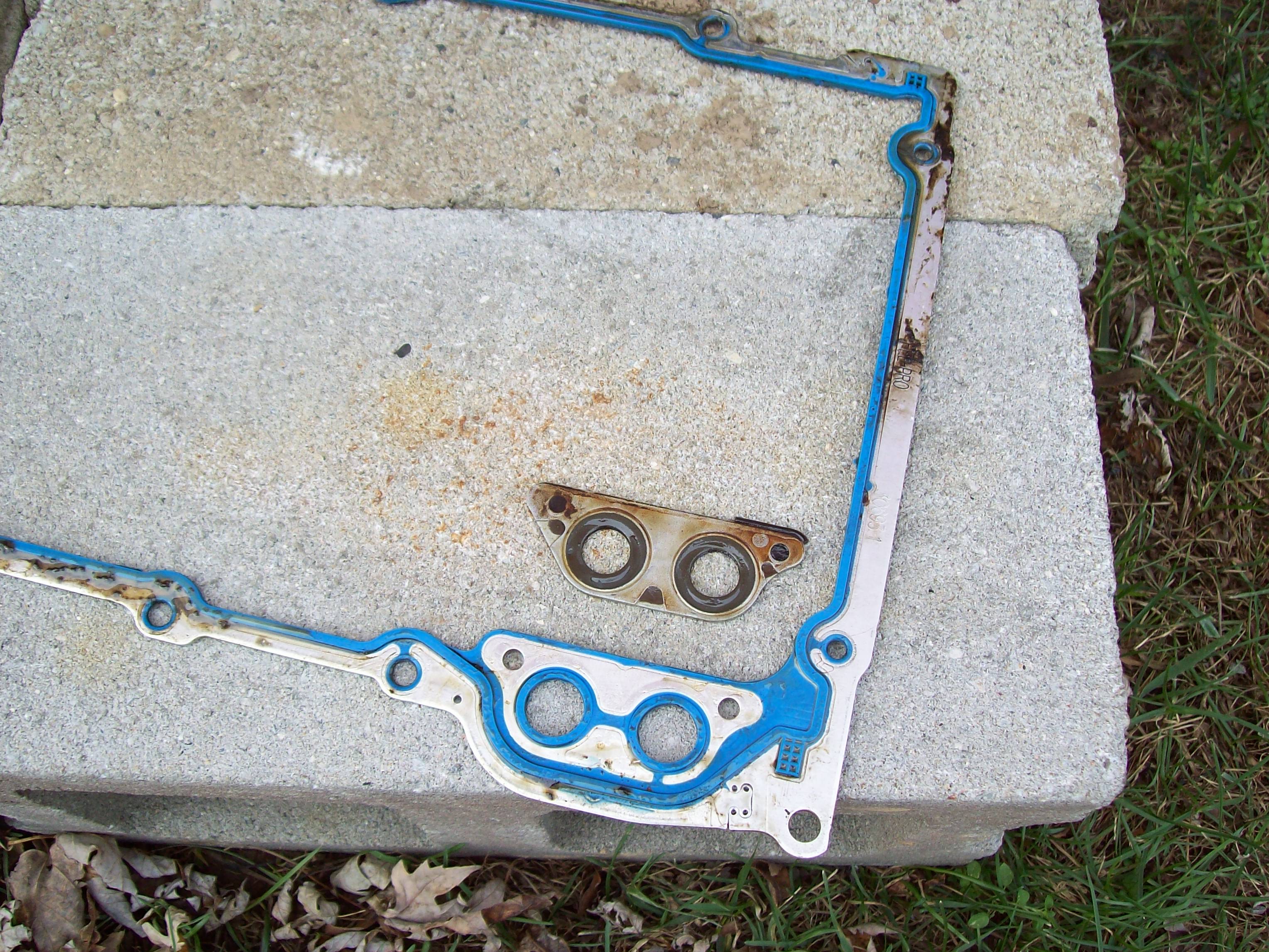

All these years that I have been working on Cars.. and Trucks... I have always told my Wife
I am never surprised as to what I find....lol
and here is just another example... So if you guys have followed along with me since the
purchase of my Van that now has a nick name of ( Elmo )..... I have told you guys that I
bought from a Friend of a Friend that was down sizing his Fleet of work vehicles..
and this was just what I had been wanting.. Super Clean under the hood so on and so
forth... but I never would have expected what I found out .....
So the story starts with an Oil leak... didnt seem like much at first... I really thought it
had been coming from the top of the motor... you guys remember the valve covers were
a mess.... figured it was coming from them... but since I drove it a few more times..
thanksgiven day... and to get tires.. well the Oil leak has gotton Worse.... like dripping
watch it leak out a quart worse... so I did my inspection and then tighten of the Oil Pan
which appeared that was what was leaking... from one corner and to No luck it still leaked.
hhhhhhmmmm... OK.. so not really knowing what to expect on these 6.0's I went on
and ordered a Pan Gasket and also a Oil Cooler line gasket cause it attaches to the pan.
all the while I am thinking that the gasket was just over tightened by the last person
that was into it... they are metal and rubber compression gaskets .. and have to be
well should be torqued down correctly. so I am figuring that it was just smashed to the
point were it would not stop Fluid passing by... so take a look at the pics.. I think it will
be self explanatory .....
So after looking at the pics.. the idiots that worked on the Van last sure didnt know what
they were doing.. lol.. I will be making a friendly phone call later... and letting him know
what I am in the middle of... if nothing other than to educate him as to who he has
working for him..... and the understanding that he really doesnt know what he or she is
doing.. lol...
I have always stated pics tell a thousand words...
