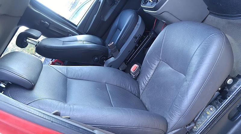

The good news is our vans have seats on pedestals, that you can take out and conveniently work with them on a bench. In my van I run a pair of 1999-2003 Saab 9-5 seats, they are black leather, powered with memory, heated and ventilated. The reason I chose those is because I wanted ventilation for those long summer trips. Those run about $100 a piece at a salvage yard. Pretty much any passenger car seat would work, as long as you are handy with a drill. I only had to make 4 holes in the pedestals to fit those Saab seats. Doing the wiring for all those "features" took me longer.

Ok perfect, that's what I was thinking! How was the wiring? Just curious.
