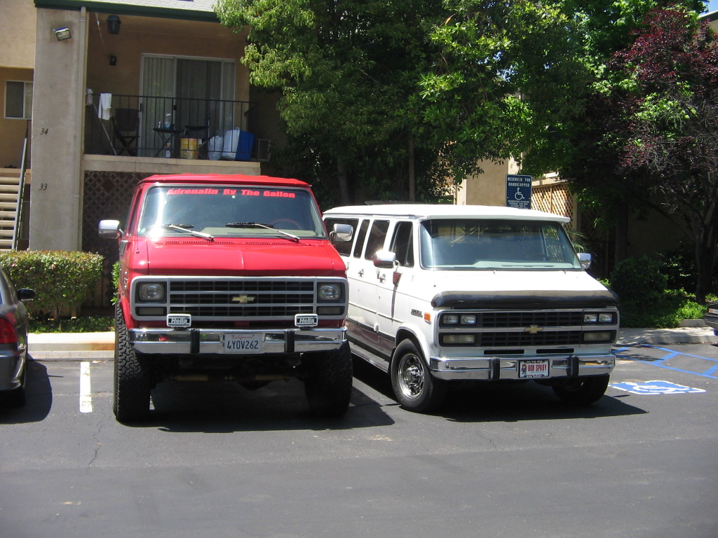

I have 2 G30 454's a 92 & 93 both are throttle body. the 92 didnt have a cat convert and got 8mpg, so I put a 3" exhaust and put a new cat on it and got 11mpg in town and 14 on the freeway. open up the tail so it can breath, the sets back pressure, keep a good 02 sencer on the exhaust pipe so the computer knows whats up, economy set the dis at adv 4 deg if its power you want move it to 11 deg, it has a cap & rotor they go quick if the blocks lopes, if the air filter is dirty the block gets no air no power no mpg.
