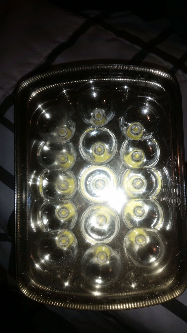

Hello,
These lights were pulled off my chevy express 2015 2500. I did not pull them off, PO did. He gave them to me when I bought the van. I want to see if they work. How can i bench test them? I couldn't figure it out on charm.li

It's pretty basic. Just clip a ground to one prong and touch the the others with 12v and see what happens. You should get a high and low depending on which prong you power up. You're not going to hurt it by getting it wrong. If you get a low beam with either prong switch the ground and you should get the low and high when you switch the 12v back and forth.
You could also unplug one headlight on the van from under the hood and plug the LED light into the harness and test it that way too. Just turn the headlights on and see what happens. Looks like you have plenty of slack in the cord to plug it in and set it down under the hood.
If you want to get fancy you could test the vans plug for ground and power with the lights off, low and high. Recreate that with a jumpbox or leads from the battery to see if the LED does the same.
