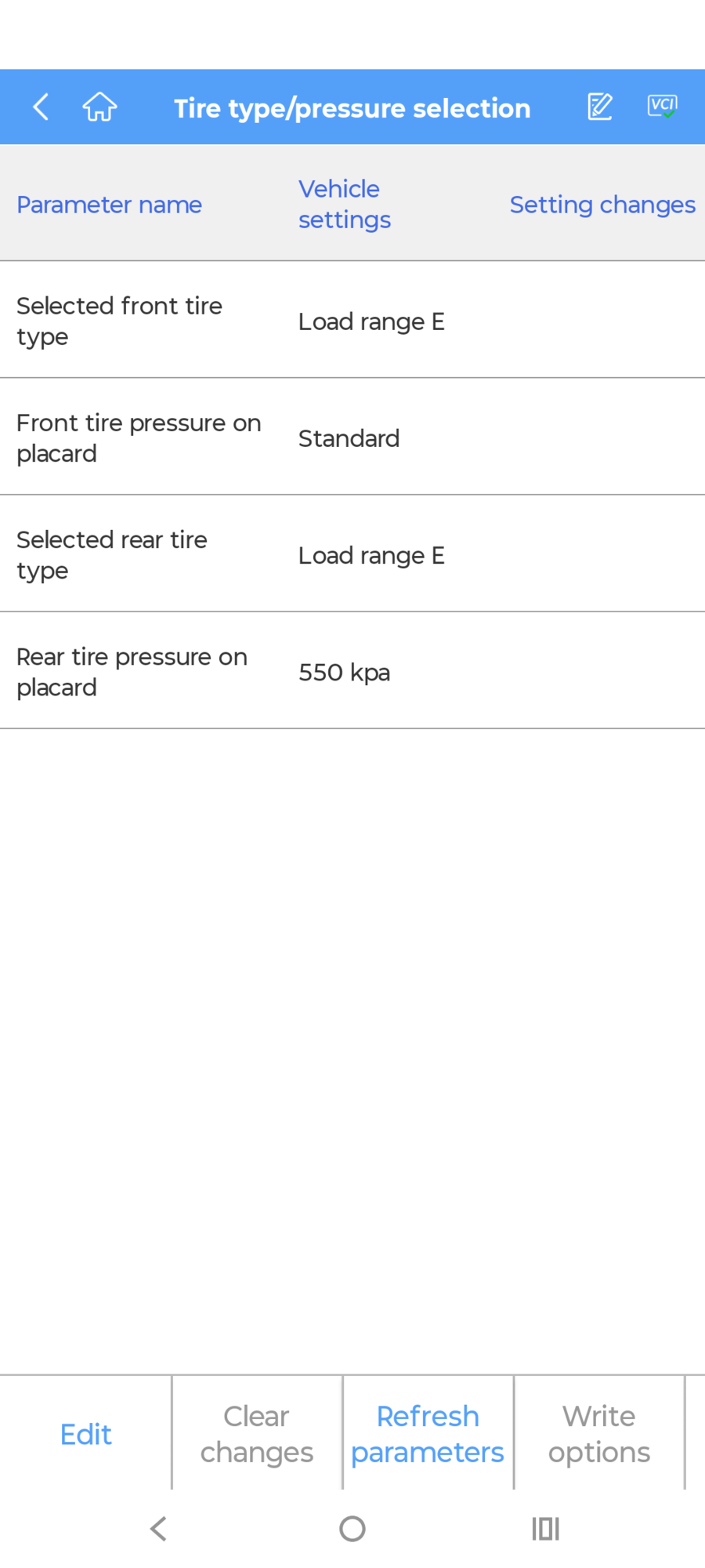

I just bought an
Autel AP200 Autel AP200
and it appears it will be able to adjust the TPMS pressures. I haven't done it yet but messed with it a bit. I was able to change the rear from standard, but I changed it to 550kPa which is what's on the door sticker.
