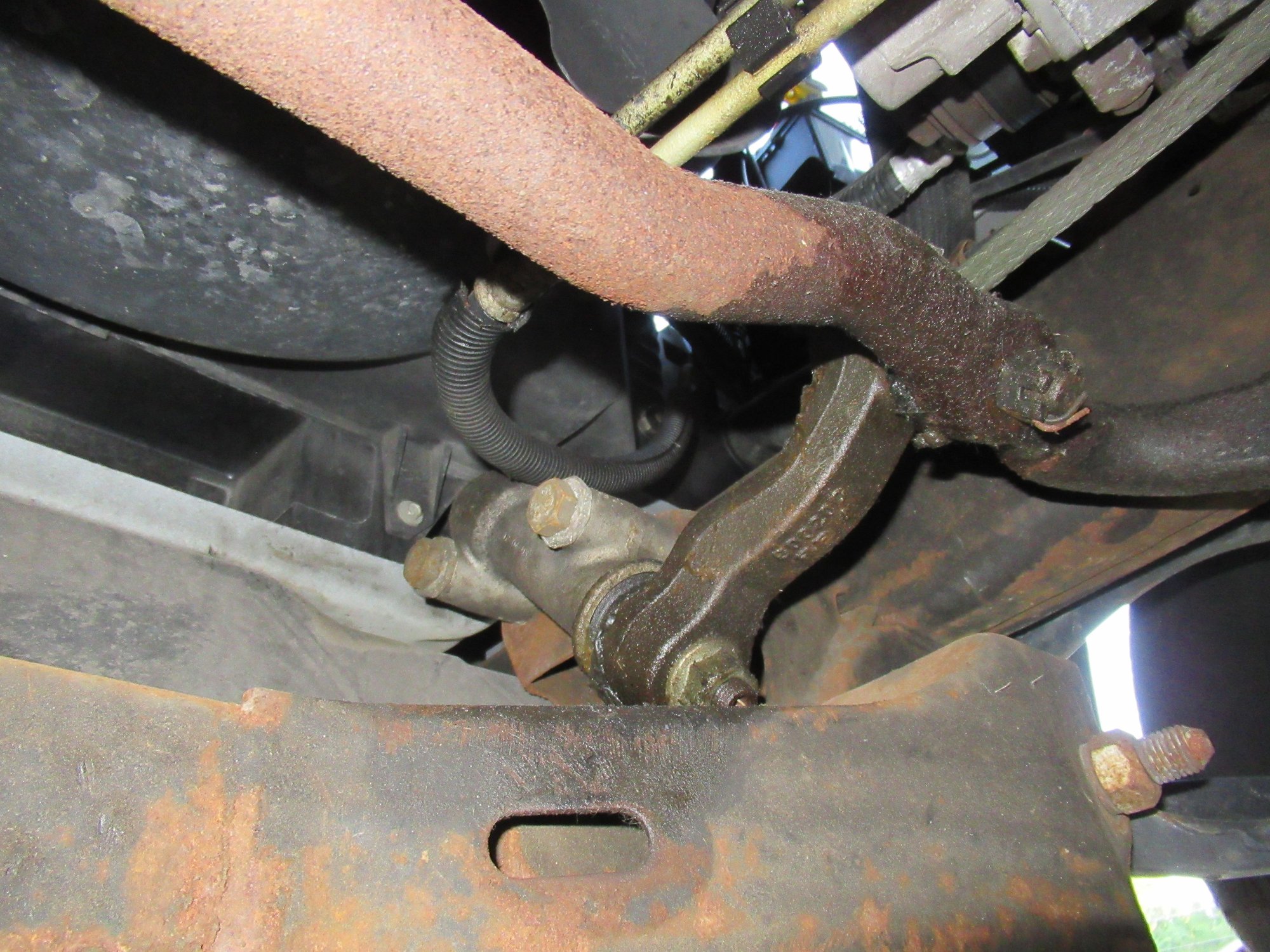

Anybody install one of these after the fact? I have a recently installed bracket but no hose. They are fairly cheap but unsure if it's worth the trouble on a vehicle without a skid plate. I also have to find out what those lines are, something is spewing oil over the passenger side of the engine.
https://fme-cat.com/LiveDocs/MOOG_PS_Bulletin_27027.pdf

I found it to be worth the trouble in the end. This van has had quite a few oil changes and grease jobs since the idler arm was last replaced and it was obvious nobody was greasing the idler arm.
