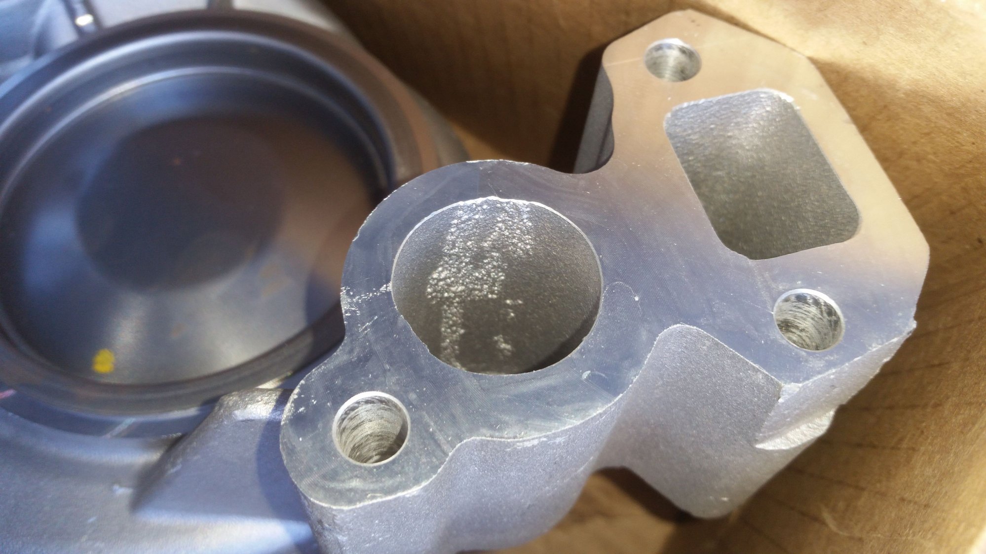

Got it all off and it looks like I may have gotten a used water pump. there is a green coolant looking stuff in there. also saw dust inside where the rad hoses go into? take a lookie
Is this thing used? did rock auto screw me? Also I noticed that this AC Delco pump is made in china. Is this pump going to fail sooner rather than later? I am also worried that this pump might not be able to handle the NEW Rad which is an aftermarket MAde in china probably low PSI. Will the different pressure cap kill the pump sooner rather than later?

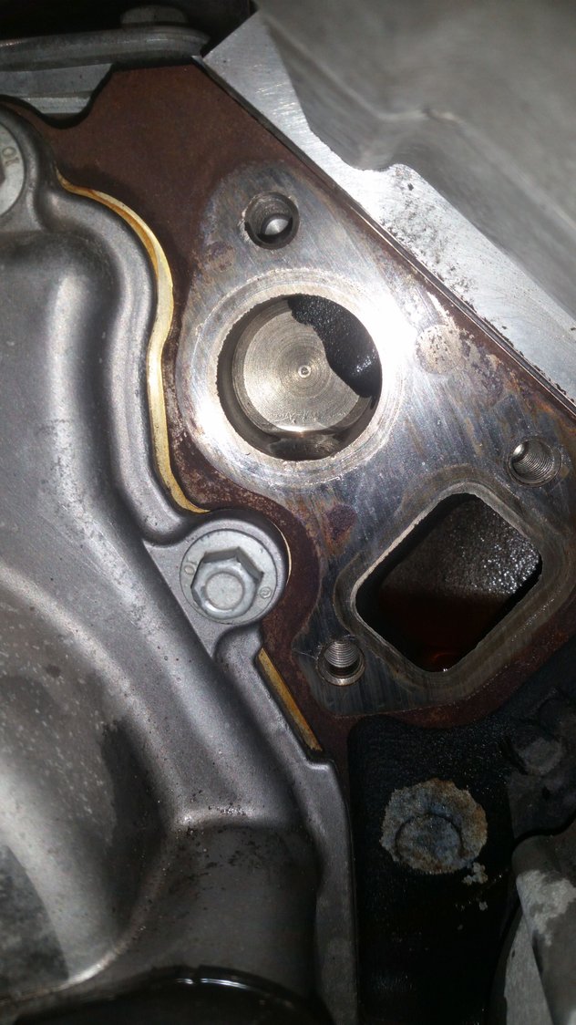

ALso I left my coolant ports open in the air for one night and some rust started building up in there. Is this a big deal? See the befores and afters.
AFTERS
You can see inside the hole, crapped build up over night. Is it just a little surface rust right there at the front it did it buildup more inside?
I also dropped one of the gaskets and it got bent, I just cleaned it off and used it to install the pump, but I am having second thoughts about this pump. I wonder if that gasket will work now. I was kind of in a hurry to get it installed.

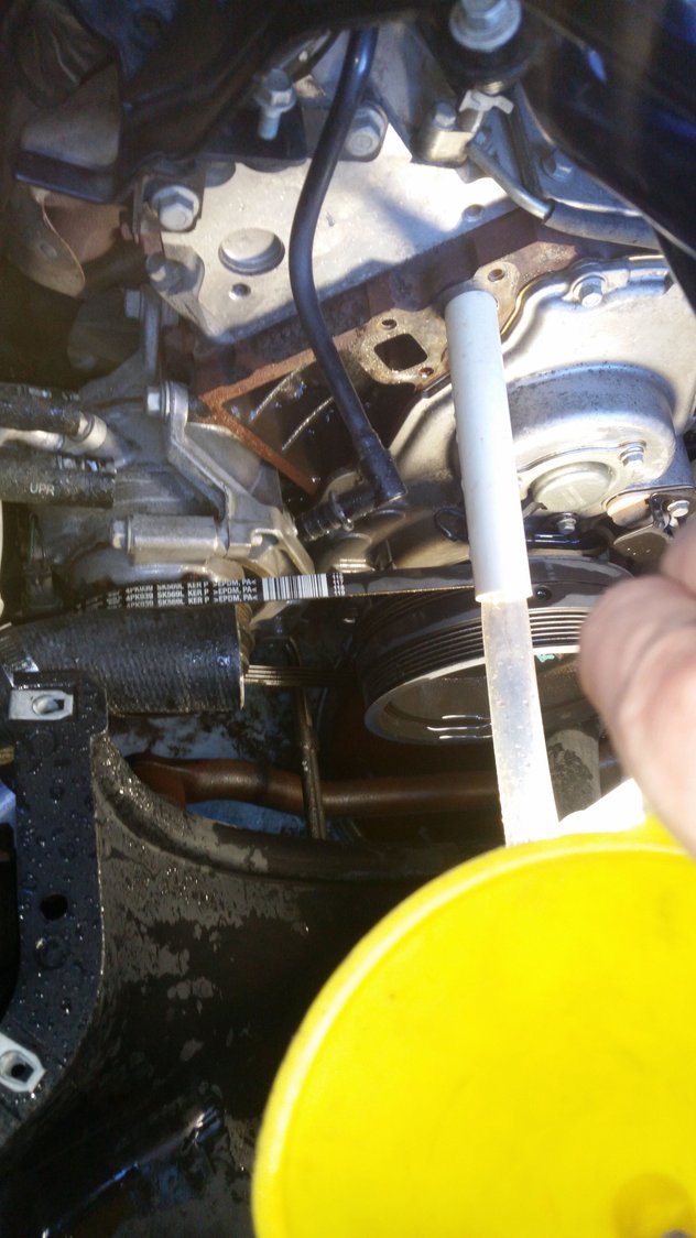

And I couldn't figure out where the engine coolant drain block is because I have no picture to reference. I ended up just flushing the garden hose water from the block using a hose and funnel with a pvc pipe. Use some rubber like from an old bicycle tire to get a good seal. Then flush the garden hose water out of the block with your solution. (I just did 50/50 AF/water)

The dirt inside the water pump just looks like rough casting. It's fine. If you want to know if a piece like that is used you have to look at the bolt holes and see if there is a scar from where the bolt head torqued down and cut into the aluminum a little bit. Look at your old one and you'll see what I mean.
