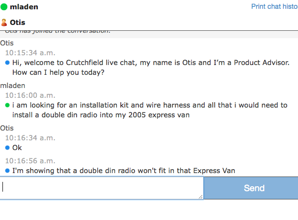

i have a giftcard for crutch field and wanted to get installation kit, and they said that double din does not fit in my van
its an 05 express 1500
theres all sorts of adapters looks like at walmart or something...
anyone know the part numbers to all the parts needed to install a double din?
seems to be all sort of confusion about what harness would work and all...
thanks in advance
