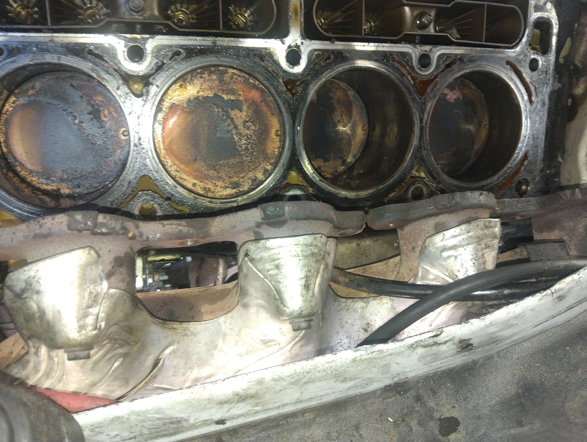

I decided to start the head gasket process
So far I have removed the dog house , radiator, spark.plugs and wires, valve covers ,both dipsticks and oil filler and the right side exhaust manifold
I'll continue the intake manifold and the right side head
Is there anything I should look for

All right guys I got the head off I can't see by my eye anything wrong with it no special patterns . Do I need to take into a shop and have him do the magnetic thing to it

Use a straight edge to check if the head has warped.

Thanks for the reply I did and it was not warped we're putting it back together now with a new head gasket hopefully that's what that was it

Ok guys that didn't fix it but there was low pressure all along that side so I figured its got better pressure now but still oil in water
What else could cause this could it be a water pump is not transmission fluid it's oil that's not the oil cooler
I am at a standstill so somebody can educate me on this I'm on the side of the road hoping you'll get back to me real quick thanks for all your replies I do appreciate it
