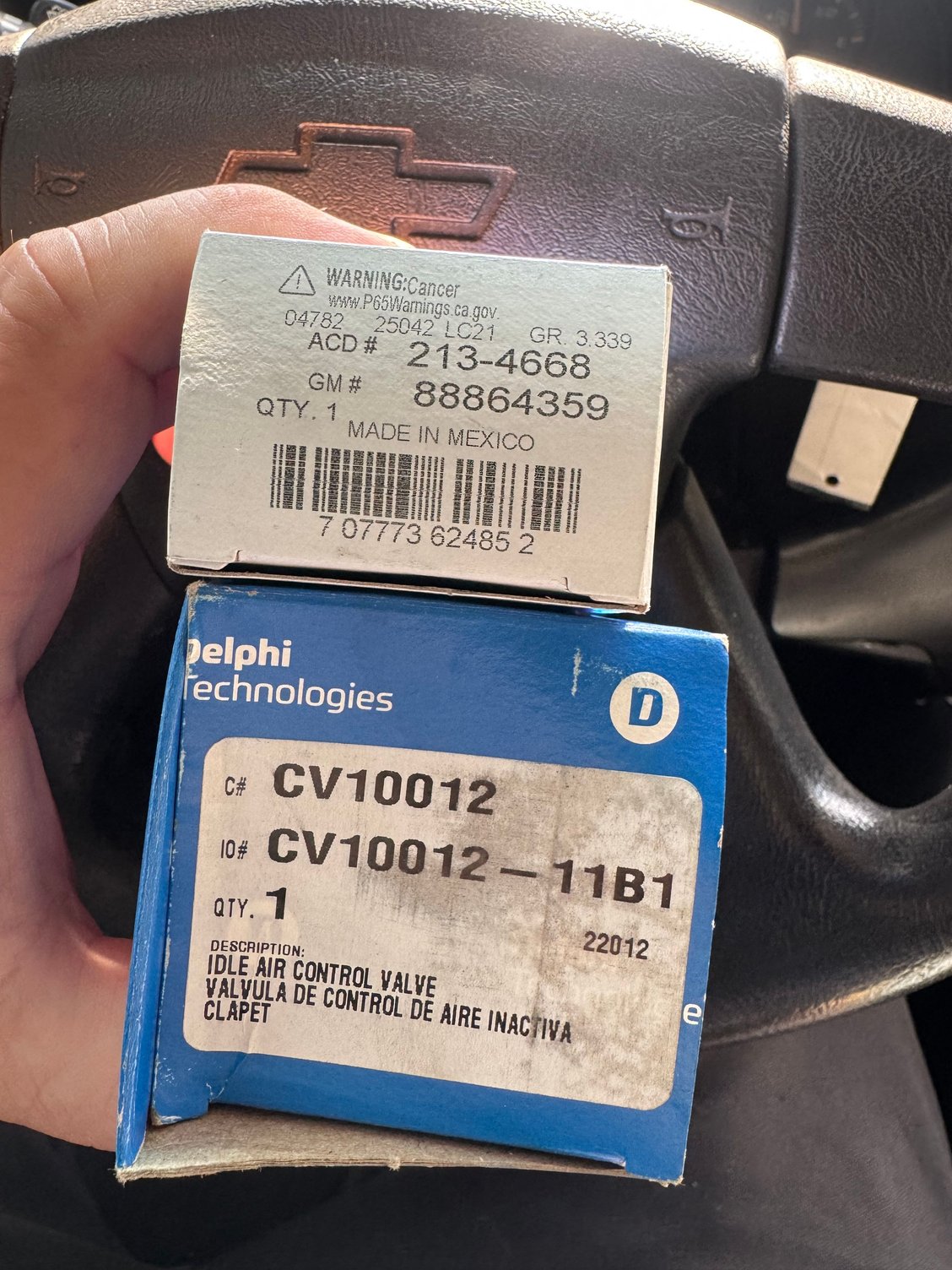

Hello forum,
Just wanted to share the part numbers that worked for my 2004 Chevy Express 3500 6.0L LQ4 with a cable throttle body:
  • Idle Air Control (IAC): Delphi CV10012
  • Throttle Position Sensor (TPS): ACDelco GM# 88864359
The TPS was easy to source locally—no issues there. However, the IAC was a completely different story. I went through a major mission trying to find one that worked properly… I must’ve ordered at least six different ones before finally landing on the right one.
Hope this saves someone else the headache!

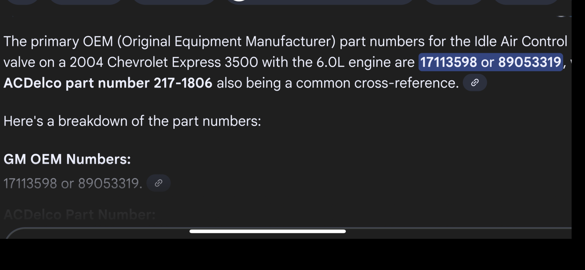

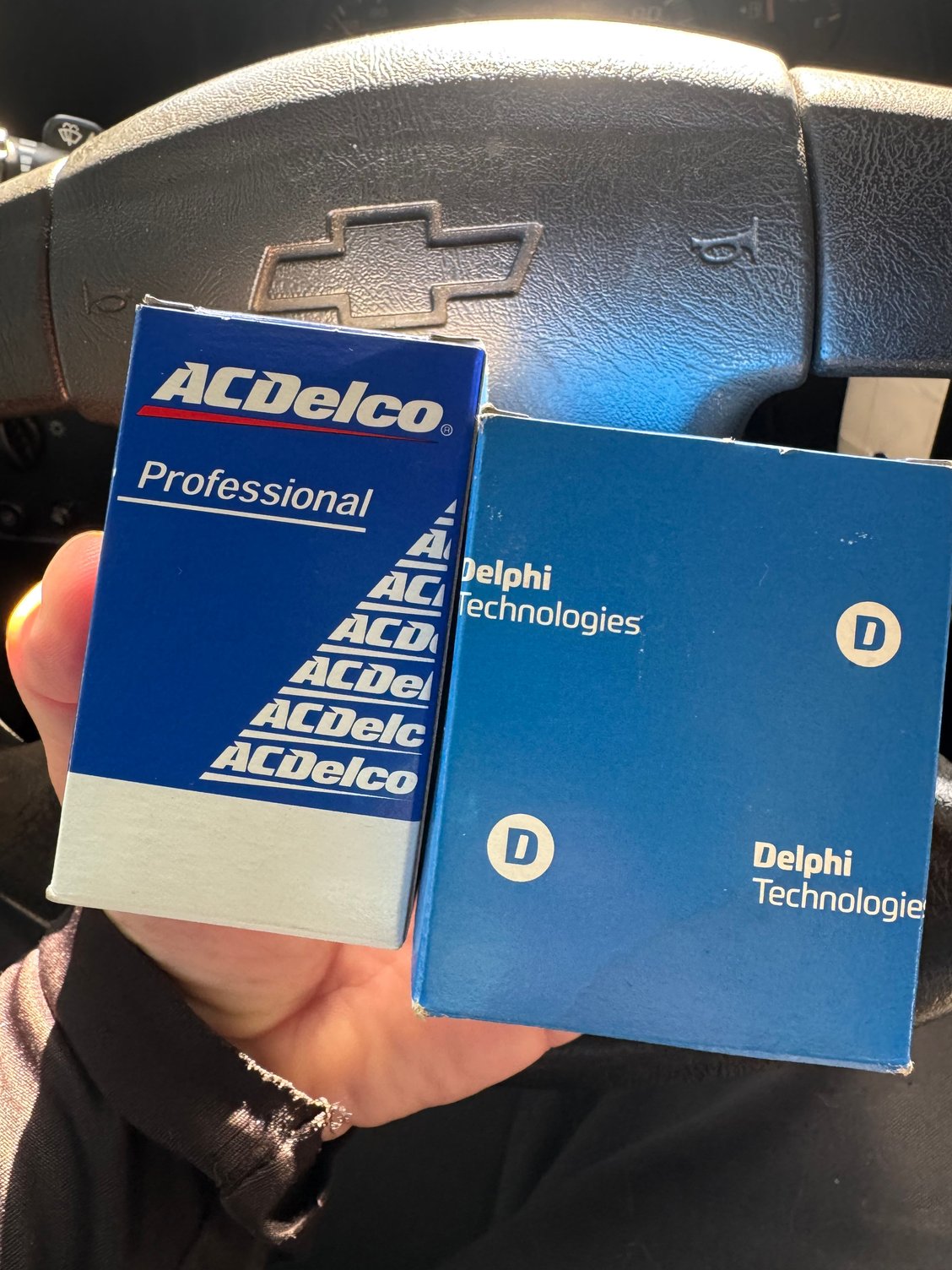

The above part number for the IDLE AIR CONTROL is WRONG!!!
i apologize for that…. Even tho the above IAC worked. It wasn’t 100%
here are the correct part number for the IDLE AIR CONTROL…

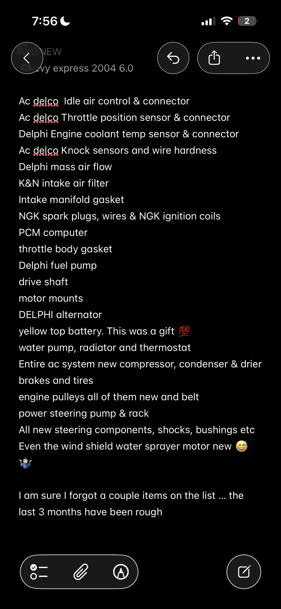

Small list of things all done recently 😅

I'd ditch the K&N and replace it with a good paper one. If there is too much oil it can get on the wire on the air flow sensor and cause it to read inaccurately so clean it when you replace the filter.
