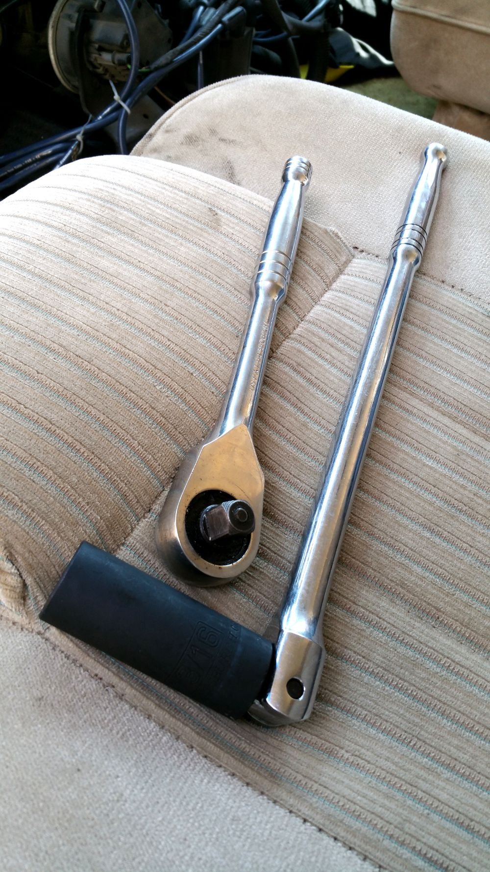

3/16 deep socket, 1/2 ratchet, 1/2 breaker bar

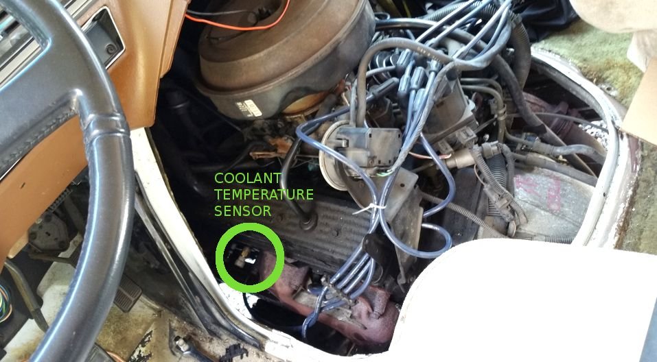

But where's the COOLANT TEMPERATURE SENSOR??? you will ask, I was looking for mine as well, here it is.
That is it. Like Lego, remove the part, install the part, problem fixed.
