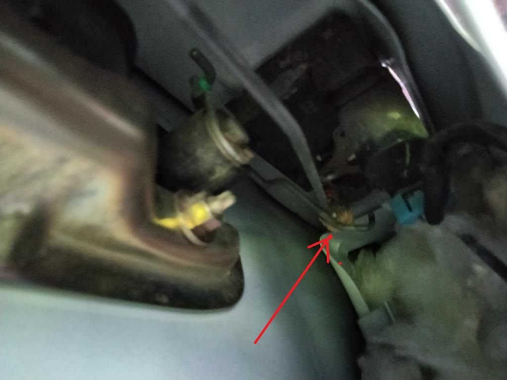

Since I’ve had this 05 the side door has had issues.here’s the order of priority.
1.key lock lever is unconnected at low end (opposite end of key). Now I know why the key won’t lock or unlock.
Where doe’s the lower end of this lever connect to?

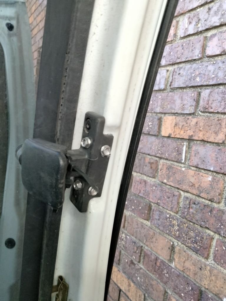

3.the window latch was detached from the door, I managed to tie wrape the side widow ghetto style. The good news is I was able to reattach the latch.

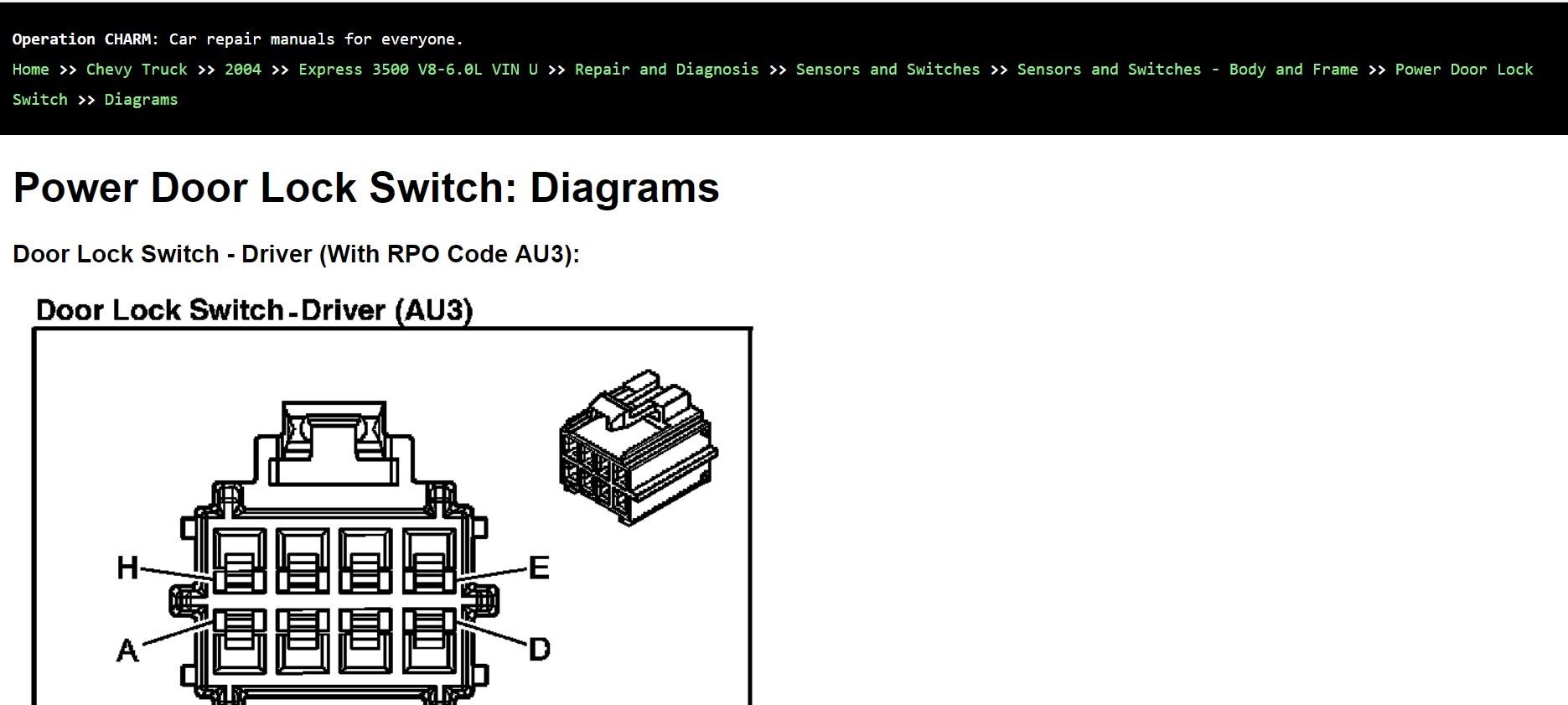

I searched the charm11 could'nt find a exploded view of where the key lock lever attaches to. I believe this lever sometimes grabs enough of where it's supposed to be connected making electric door lock to acutely work for both lock/unlock but not consistently just a small % of time.

the lever was dissconnected at the orange grommet.I got lucky the orange grommet was still attached. didn't notice which hole it was in but will take a decent image an document this issue for future reference.I believe this grommet could have fialed bc those levers stay attached pretty good. I will purchase a new grommet or snag a couple next time at used parts recyclers.I resolved the dissconnected lever an now have power door locks an manuel w/ key that lever was preventing the power door locks.so I can lose my 2'long painters stick to lock an unlock ,
