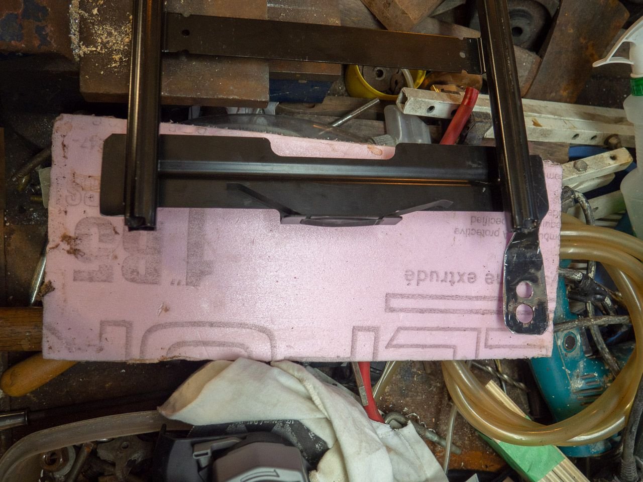

The patient.
The drawer comes off the frame with a couple of fasteners.
The frame was meant to simply drop over the seat mounting studs. That wasn't going to work with the Savana seats. The spacing of the holes side to side was perfect, but front to back it was too long and the tabs didn't fit underneath. A little modification needed ...

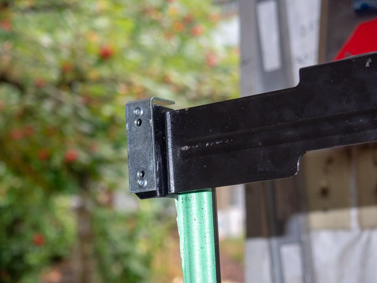

The front tabs would simply go over instead of under. Back tabs: (pictured here) needed a new hole and a bit of notching with a grinder. The other was removed completely ...
... and replaced with an angle bracket which was riveted on.
A threaded insert was pressed in, for easy disassembly.
A small hole was drilled into the back of the seat base, where a #6 screw could go through and thread into the angle bracket.
