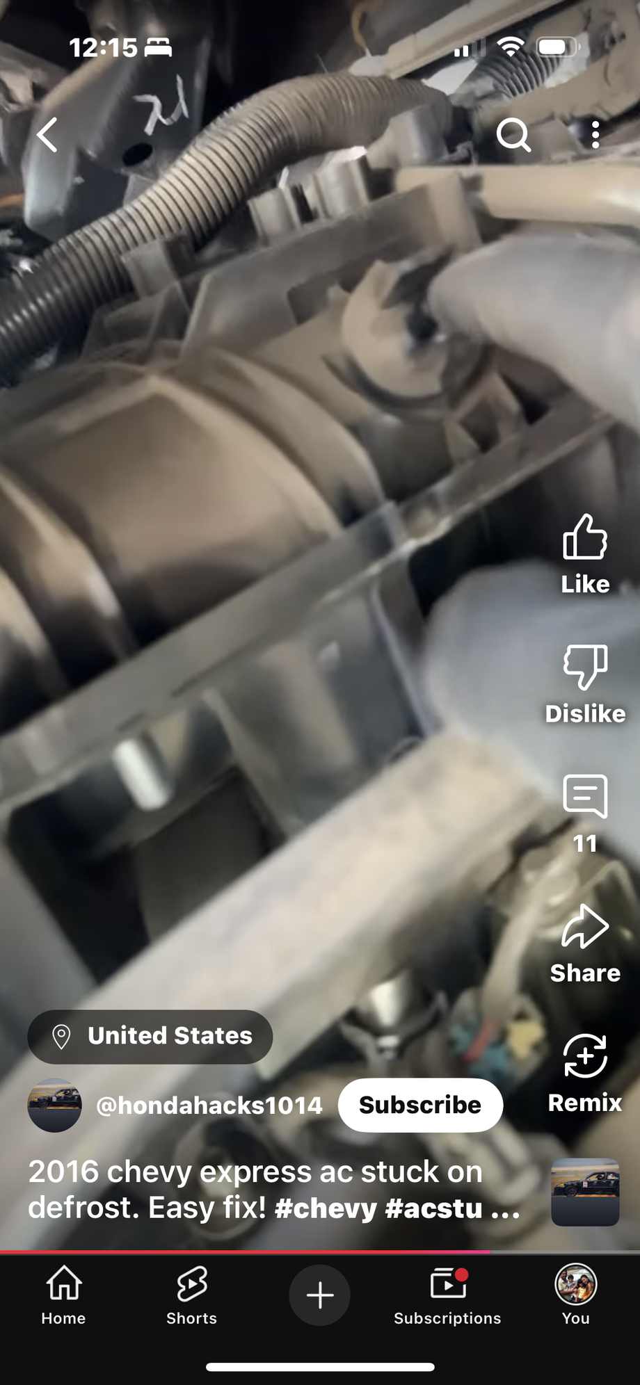

I couldn't find a drawing, but you should be able to follow the hissing/sucking sound. You'll probably need to remove the doghouse.
After removing dog house found where hose connects to the intake manifold on the passenger side. Connected new hose and got it working properly.
thanks for your help

Open dog side, top of the engine u can see that, px side
