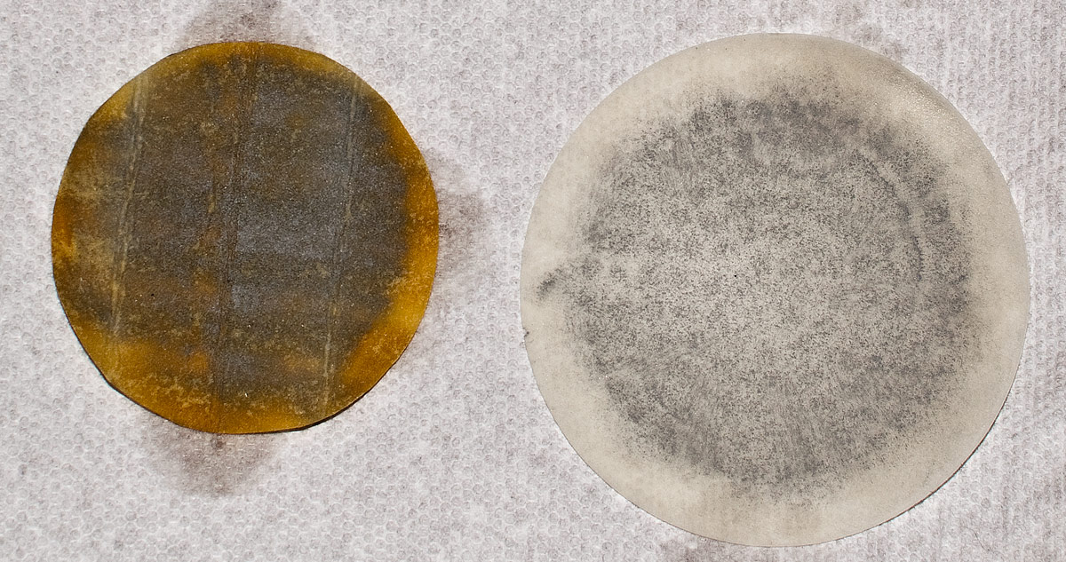

I decided to open up my old oil filter. (ACDelco PF48e installed at GM dealership)
There's nothing new or interesting in it. You can find tons of pictures on the internet of gutted oil filters, and sensational videos claiming this brand of filter is better than another. But they are bullsh*t. They invariably discuss the intricacies of the materials, manufacturing and construction techniques in the putting the filter together. But it's completely irrelevant. Unless my filter falls off, explodes, implodes or leaks, IDGAF if it has this spring or the other, paper or plastic, silicone or rubber. Show me what matters. An oil filter has one main job. Filter the oil.
There is only one absolute way to judge the performance of an oil filter, and that is to analyze the content of motor oil in a car, using the oil filter, under real world conditions. I have yet to find such an analysis. But I did find an interesting website from 2011 that did an excellent job. Here it is:
Oil Filter Comparison Study - GM Truck Central
In that study, fresh oil was mixed with microscopic aluminum particles of known size and composition. The heated oil was forced through discs of filter media at pressures used in car engines. Then the leftover contamination in the oil was measured, and the filter elements were photographed and graded. The 31 oil filter brands were then ranked by how well they filtered.
I did not replace my oil filter with another OEM, and here's why: In the study, the ACDelco filter got an 'F' in filtering, and came in 2nd to last overall. This is a photo of the filter paper itself (left) and the collected particles that made it through the filter. (right):
And the ACDelco filters are not cheap to buy here locally.

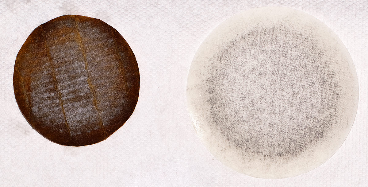

I bought a NAPA ProSelect oil filter for $4. (NSF 27060). NAPA is a 2 min drive away. In the study, the NAPA filter got a decent 'C+' in filtering, and ranked 6th overall. In the same class as some premium high priced filters. It filters much better than what GM gives you, and its excellent value for the money. The filtering perfomance is VISIBLY better:
