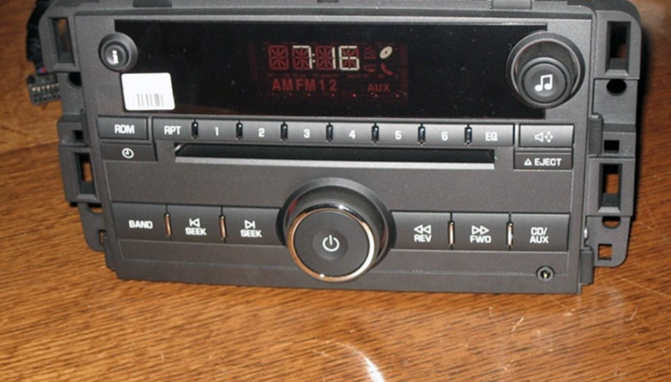

i really would like to get something that i can plug my phone into and play pandora etc, so would like something with aux, and this one looks to have it.
i dont wanna get an aftermarket unit for someone to break my window over, so stock is best, and i think this would fit
it comes out of a 2007 silver ado and my van is a 2005 express 1500 v6

Yes it will fit, but the theftlock and all the other factory crap will be such a headache. Just pick up a jvc double din. No one will break into a van to steal a head unit.....
If you don't have an alarm system....get one.

Theftlock is the factory gm anti theft on its stereo units. When you buy a used factory head unit and try to put it in your van the theftlock wont recognize it. I think you have to take it to a dealer and have it programmed to your vehicle.
Give a dealer a call to be sure.

I have sonce read that you can buy used or new factory gm stereos that are flashed, and will learn your vehicle once it is plugged in. However this process makes them non returnable so you must make sure the stereo part number is compatible with your vehicle.
Which begins the massive list of stereos that may or may not fit.
