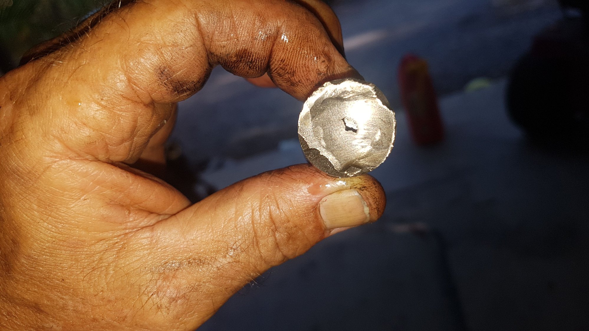

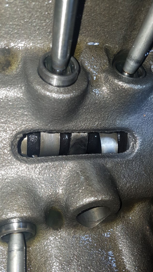

What i have is the following problem, im looking for a good cam to replace my clapped out one. I have only just recently purchased the car and was not aware of the damage that was lurking within.
Turns out the lifter on Cyl 1 is missin a considerable chunk and the cam has been ground down. So now i am in the final stages of pulling the motor out for a full clean and so i can inspect the bottom end and hope for no damage to the big end and crank ect. Dont like my chances at getting away scott free however might get lucky and only need to re build the top end!
