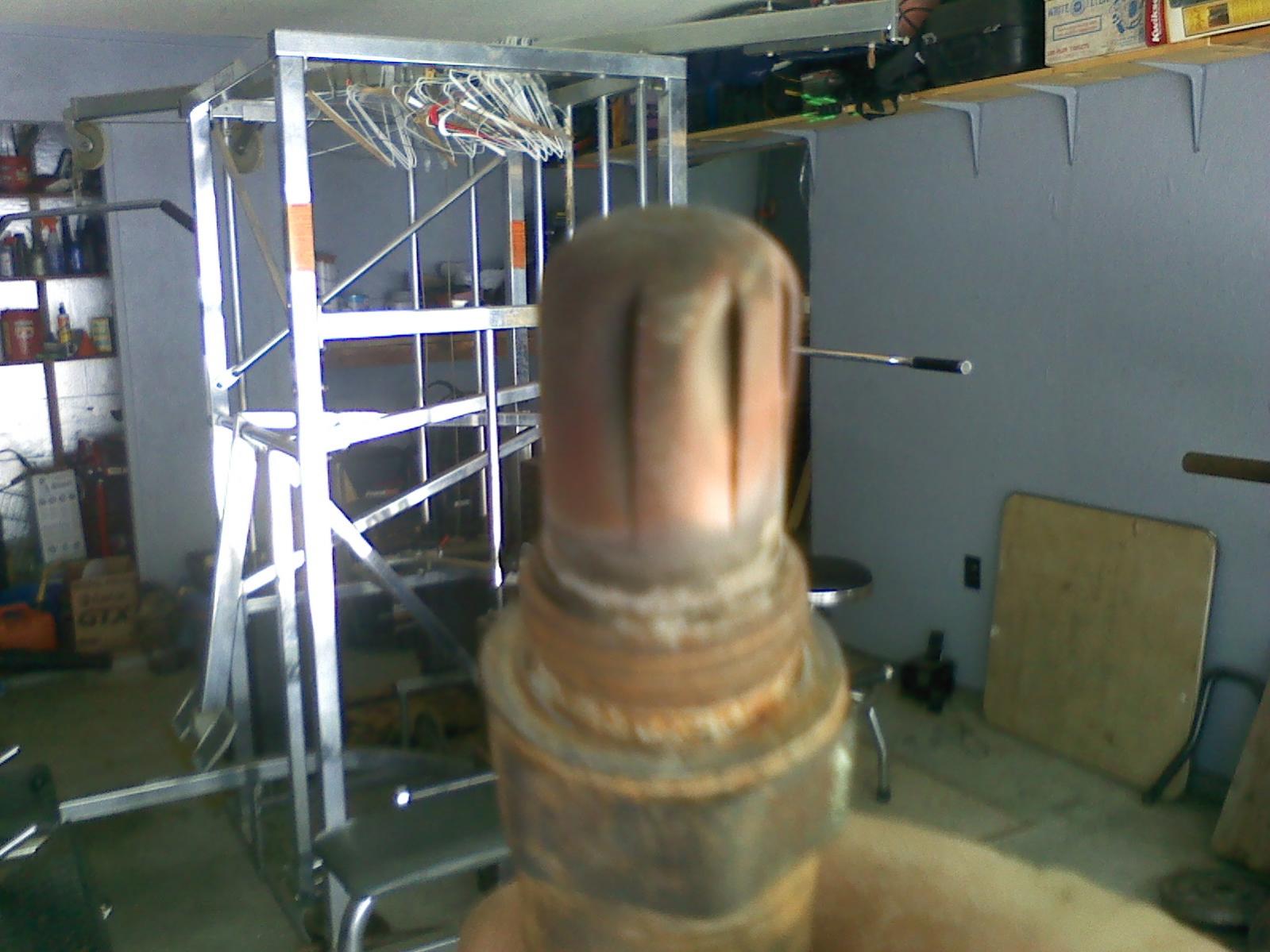

Forgot to mention this earlier. I pulled all four oxygen sensors late saturday. I didn't test the wiring or anything and basically just cleaned them (emery cloth and solvent) and reinstalled. I realized one of the sensors was different from the other three; this would be the one upstream of the cat on the driverside. The shield surrounding the element had small perforations in it; the other three had slits, resembling louvers. I didn't think of taking a photo of it until after i had it re-installed, but, took a photo of the other three; it is attached below. Also, i replaced the TPS. Of course, these efforts did not improve anything. thanks

Really doubt if the o2 differences are relevant. Just different Mfg.
