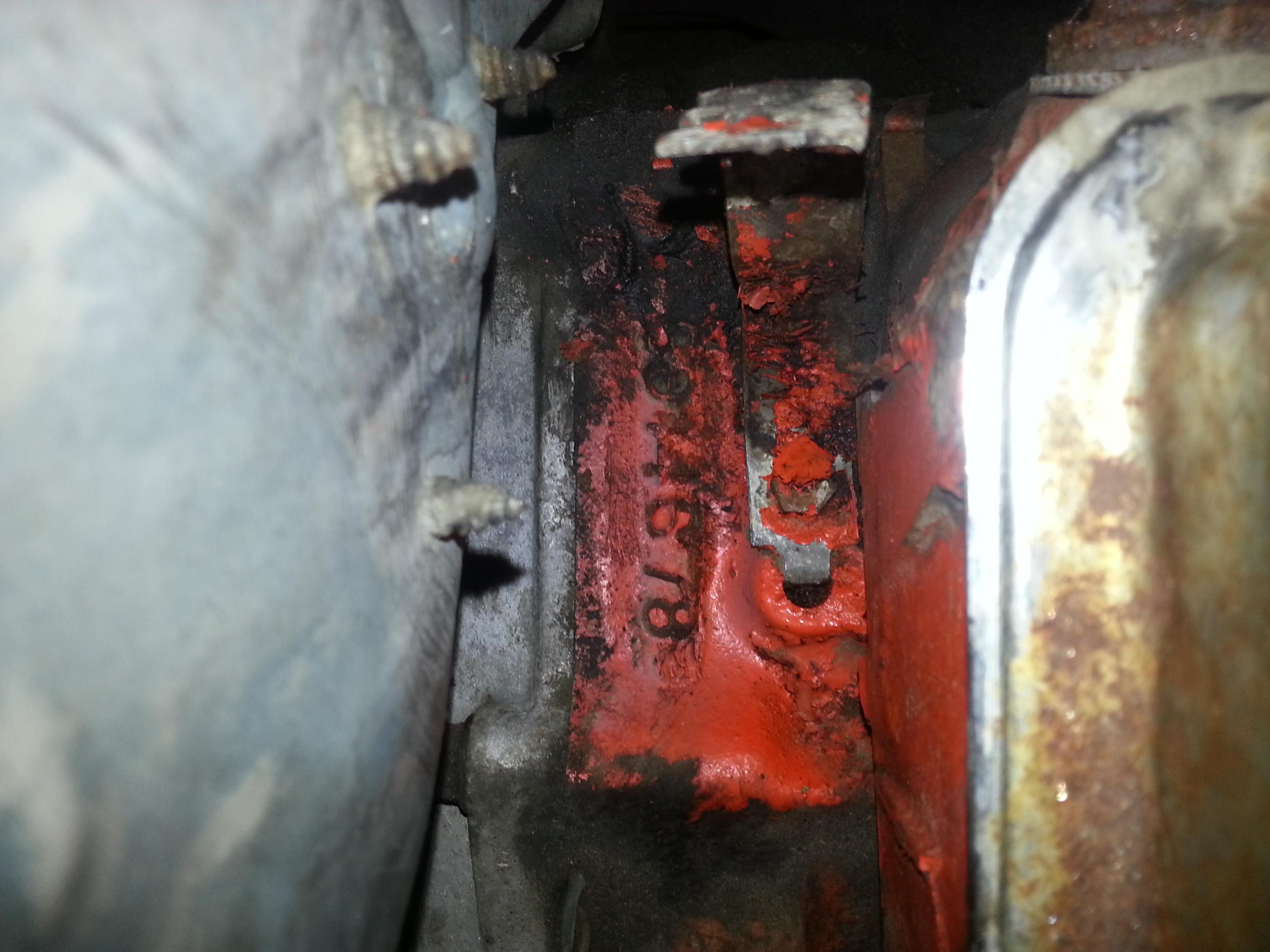

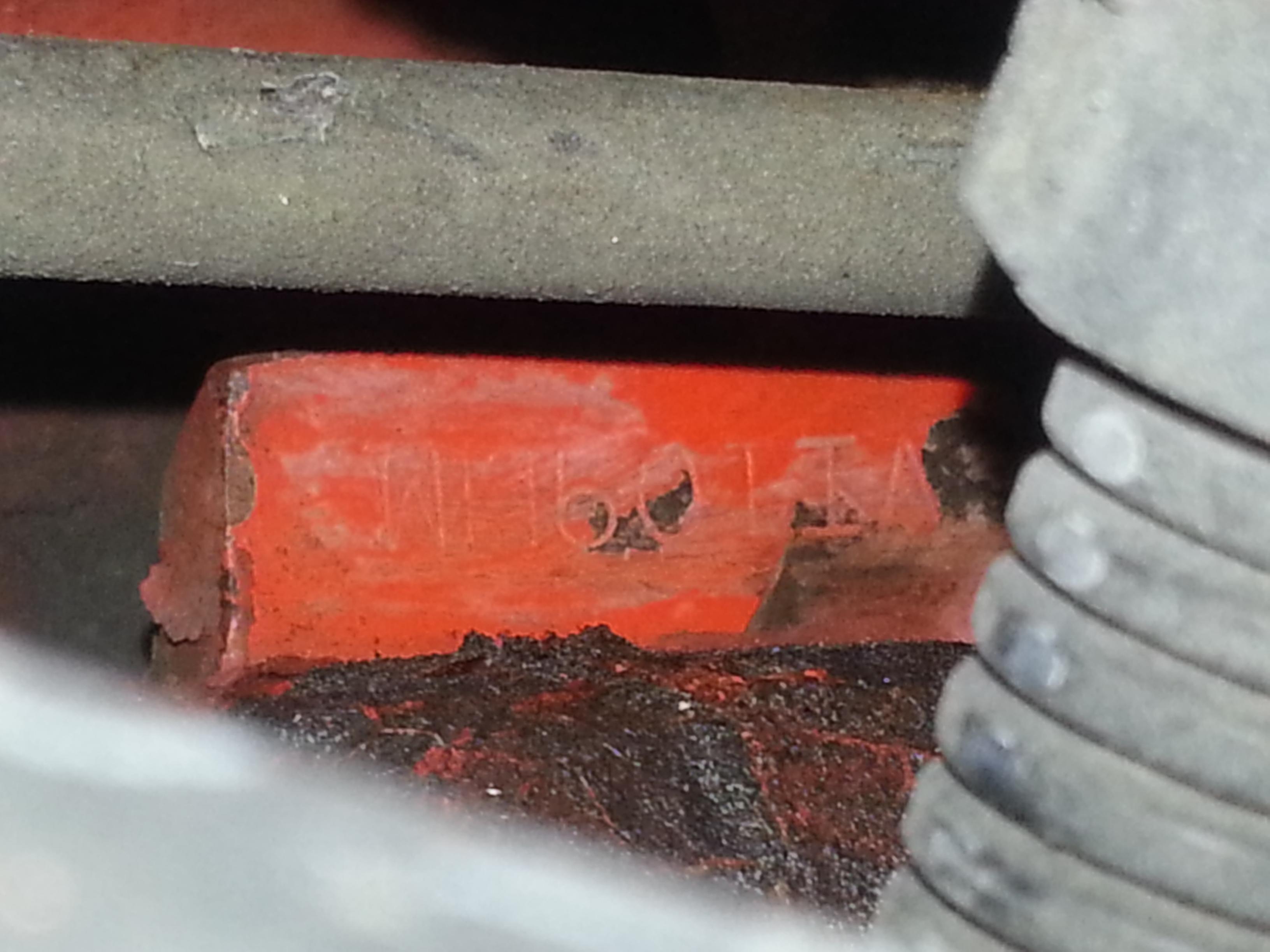

I need some help here, is this motor a 302 327 or 350? I hope this is the right part of the forum am new. I took pics of the id codes i could see.
The ID on the back of the motor is (3914678) i think but i will post a pic of them.
The ID on the front of the motor is (VI409HM) pic is up sidedown
What is the HP?

3914678 302 2 68 290 Z-28 Camaro
3914678 327 2 68 210-350 Passenger, Chevelle, Chevy II, Camaro, Vett
3914678 350 2 68 295 Chevy II, Camaro
