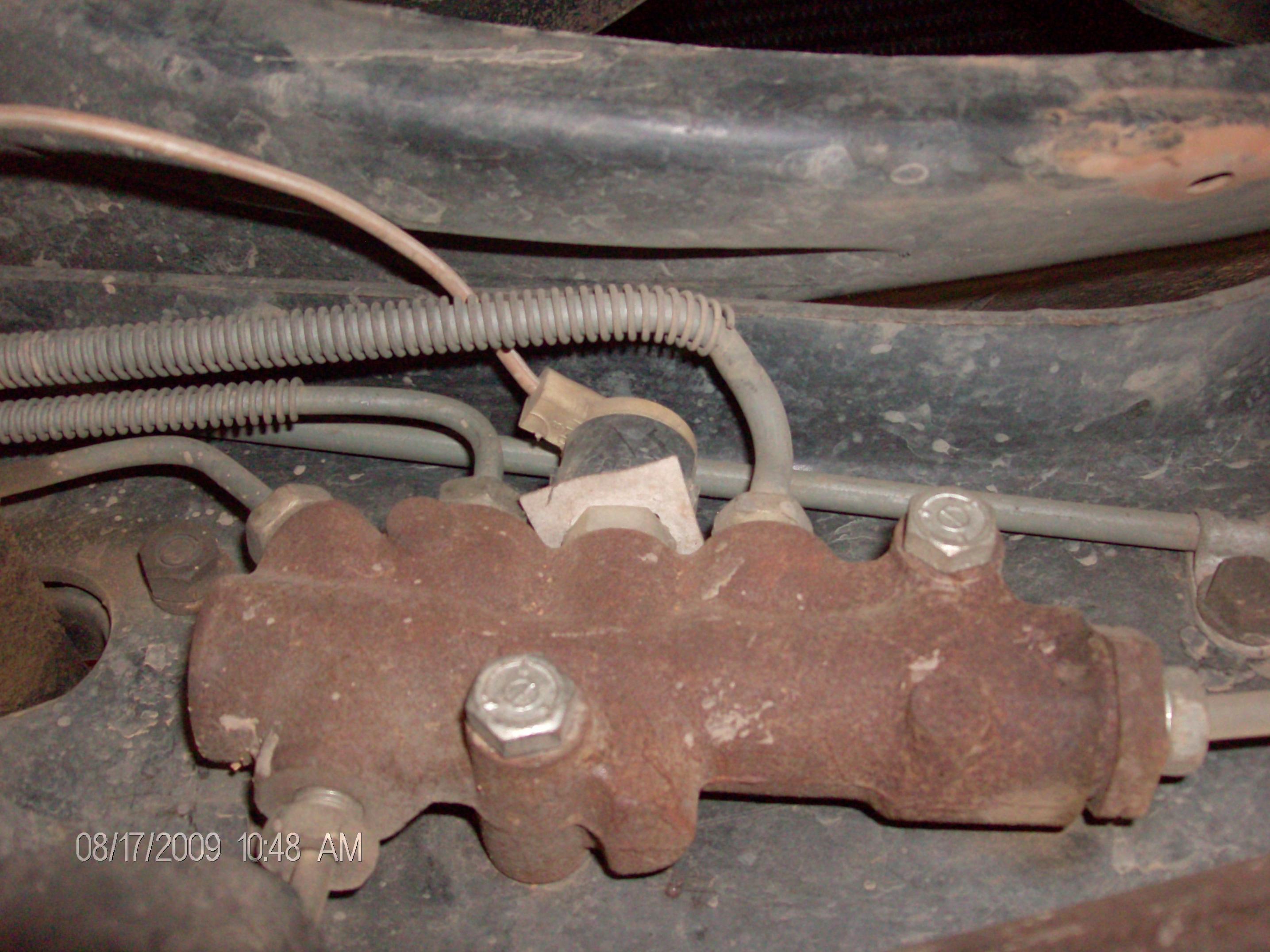

As for this combo valve, this sounds very interesting like it could be restricting flow to back right? Is it under hood or truck? I do not see it. Ah I wish I knew where pin to push in was on this thing. Is funny I googled and found same pic you posted. Is this it or not. This is my pic. thanks

the wheels can stay on the truck,might be a little more acessible with them off.the valve could very well be your issue?when you follow the master cylinder from under the hood they should take you to the vlave...it is usually right near the fan shroud..u will see all the brake lines running to it...i will try and get apic of which pin to push in for ya...should have a ruber gromet over it..

is that mine in my pic or not, it looks like all the brake lines there

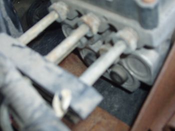

looks like your master cylinder..it could be attached to it...not sure on your ride..did you follow those lines to where they go?they should go to the valve then to your wheels or not....follow them then let me know?
the second pic is blurred but the pin to push in is on the left of the valve..

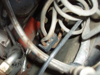

i am searching high and low and cannot find it. I try to follow my brake lines and they goto the brakes, all i can see is what i have in my pic? From what I read it shuts down flow to the rear if something was to go wrong, such as my bad caliper? correct? Are those two black rubber things in first pic the thing you are talking about?

i hope im not blowing air,damn your's seems to be way different then mine...or at least from here....what engine is in your blazer...that could be where your is ..just not completly familiar with that setup...im thinking now by looking at tha ot looks to be an abs setup...does your ride have abs braking?if so its a little different
