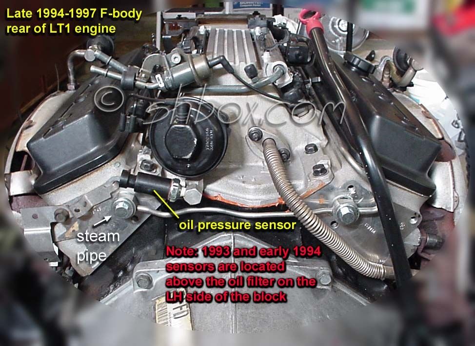

I have a Chevrolet Caprice 1996 LT1 5.7 V8 and bought a new Oil Pressure Sender Switch.
Can someone tell me where I can find this on the Engine and will I have to drain the Oil out of the Engine to replace this ?
Pictures would be a Bonus but I guess you cant have everything hehe
Thanks guys.

I have found it and it is located at the top backside of the Engine, if you are not sure if you have the right one then I would suggest you disconnect the Sensor and then check your Dash reading. All the best to anyone who is doing this job.
