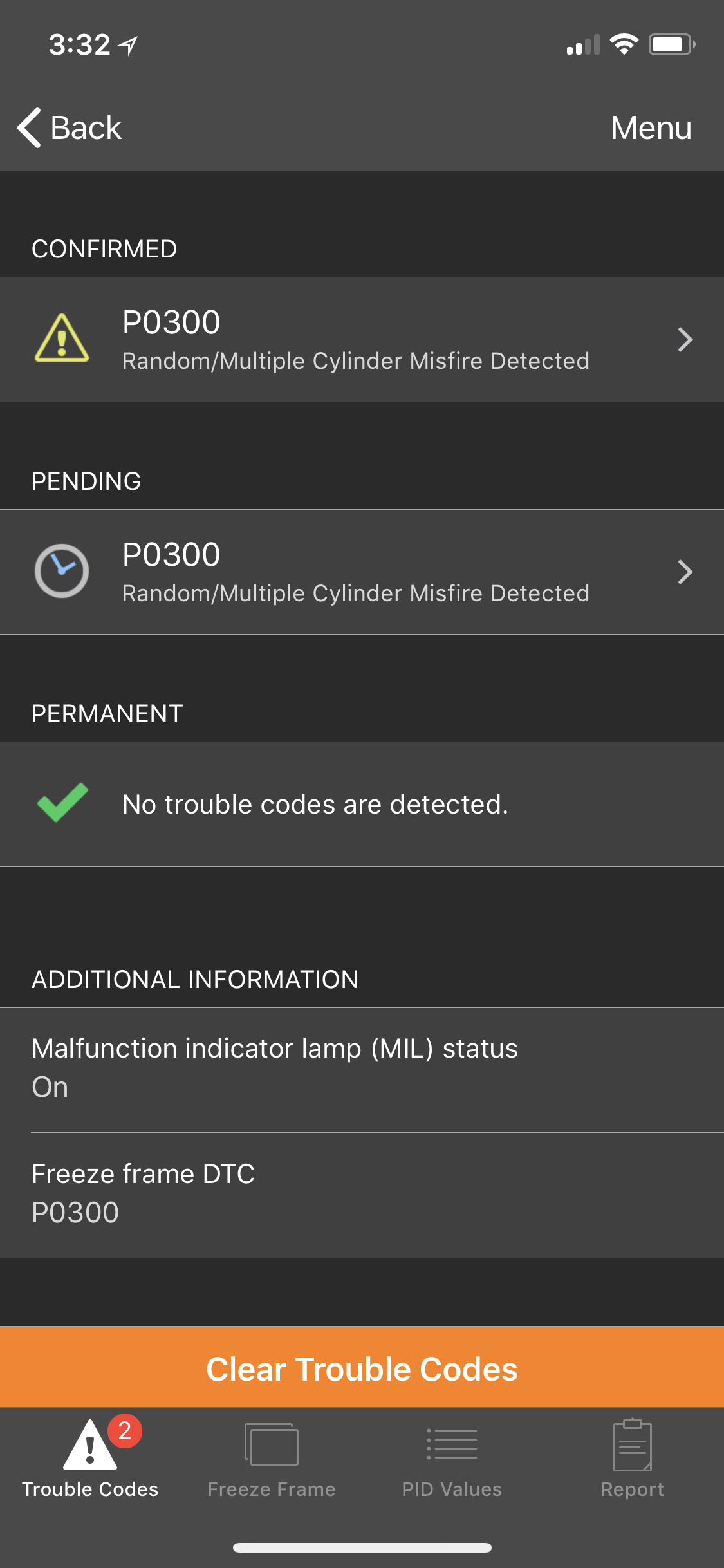

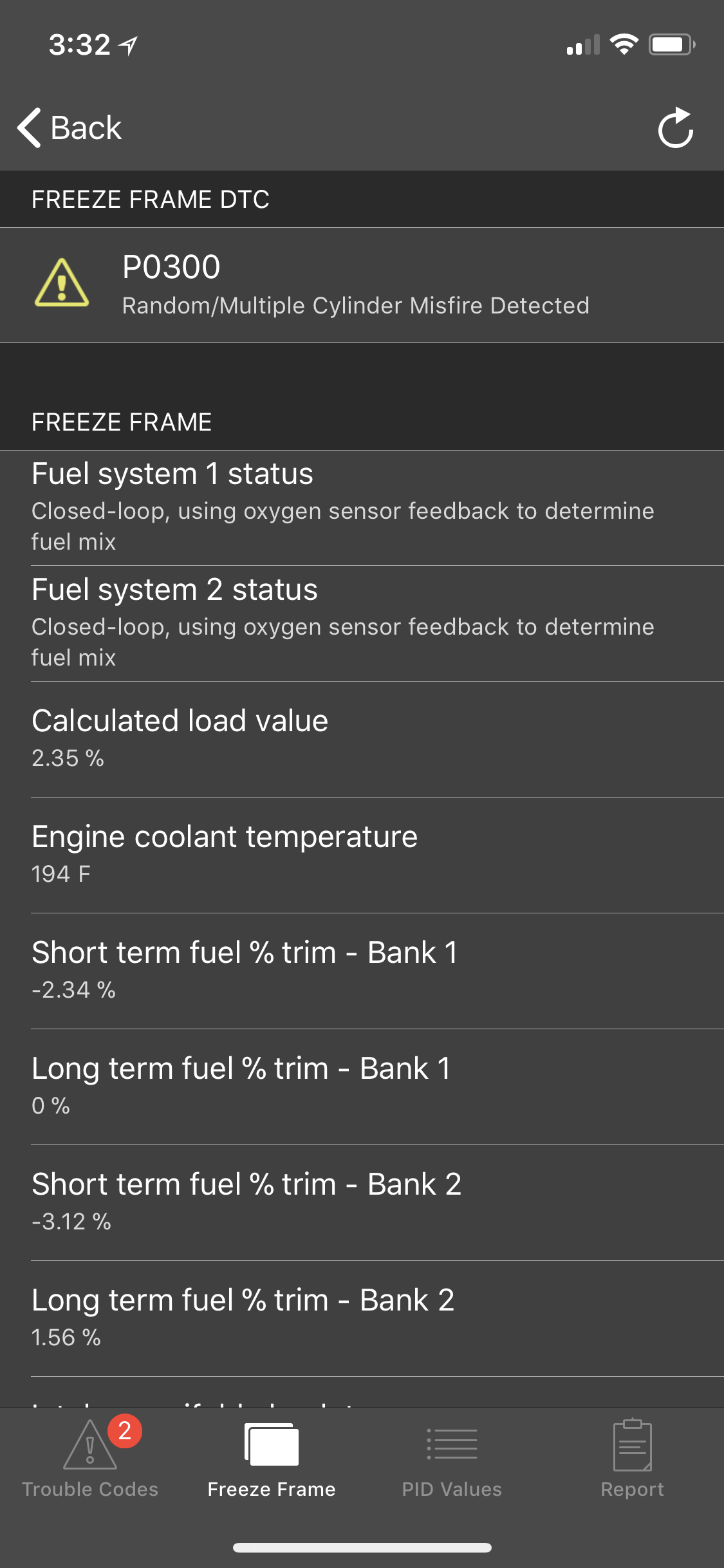

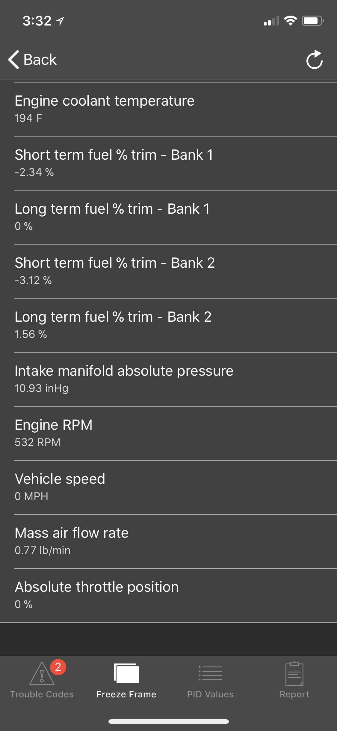

I have not done a compression test yet. My thinking here is the P030(#) code would dictate the faulty cylinder. Am I wrong? Also, I have not done a vacuum smoke test. I think this is my next test because of the freeze frame data (attached). By no means am I an expert at reviewing this type of data. To be honest, this is the first time I’ve read such data. According to the data, the P0300 was detected at 532rpm, 193F temp, and 10.93Hg. I am not sure how a warm motor at idle can lose 11 Hg in pressure from my vacuum test in Step 2.
My gut tells me it is the manifold gasket(s), cam shaft sensor, or crankshaft sensor. Any thoughts or advice would be greatly appreciated!

The P030# is the cylinder that is misfire. The rpm vrs. vacuum look normal, however is the idle 532 rpm? I'd suggest next step is a compression test
