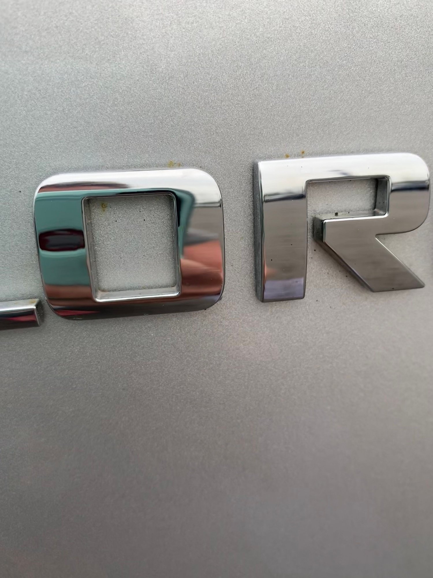

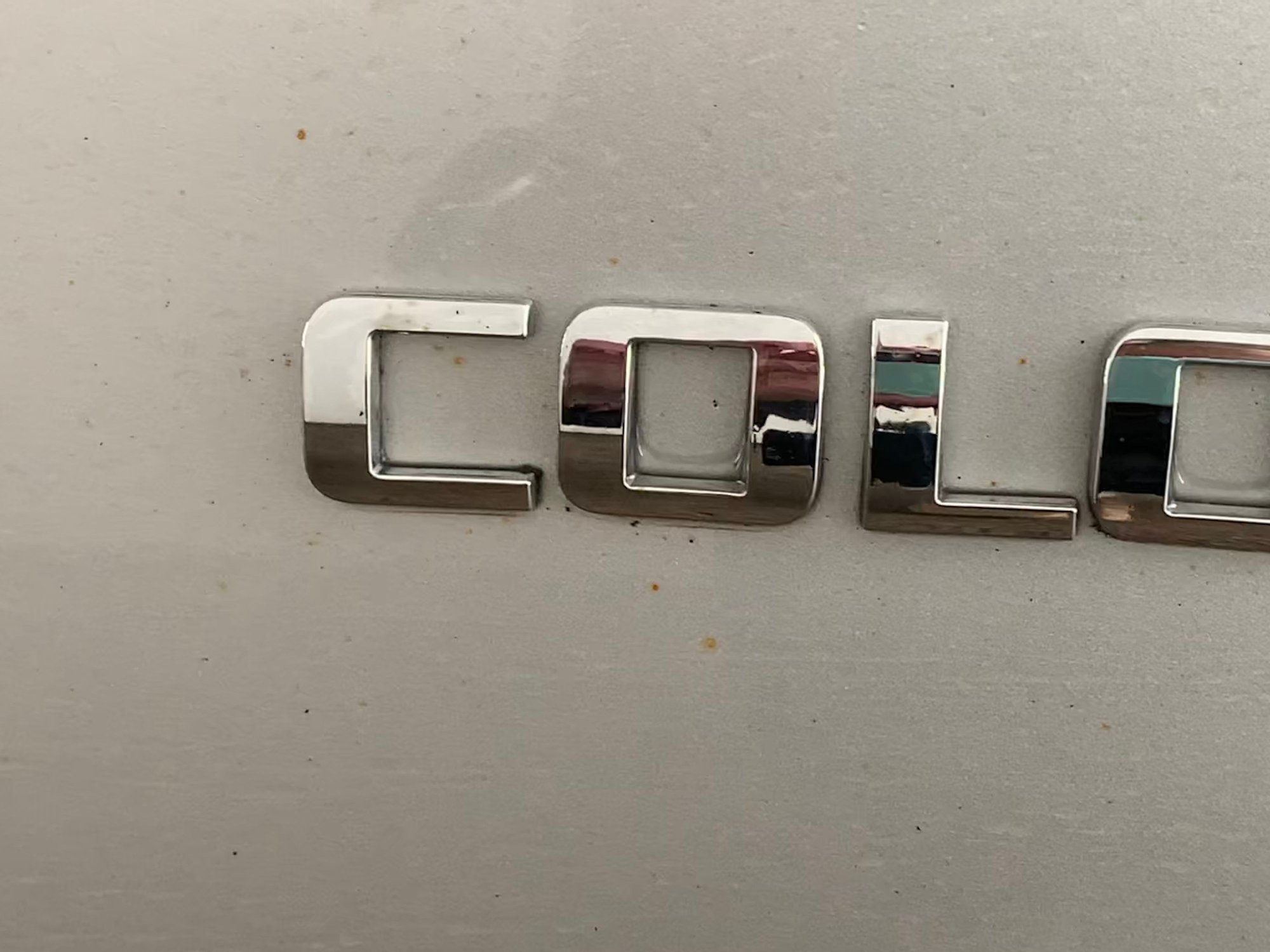

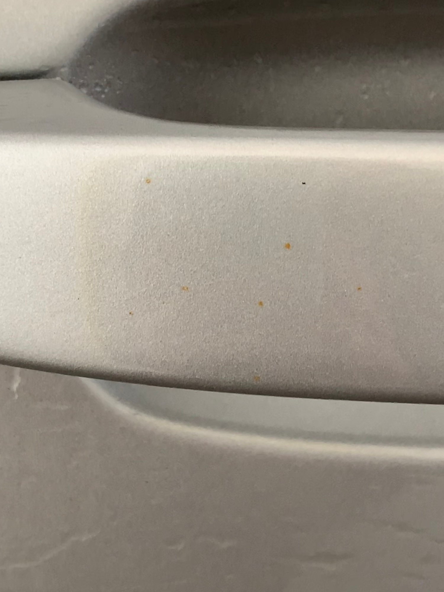

Default Same issue with rail dust. Chevrolet Colorado 2019
I have similar issue. 2019 Chevrolet Colorado. What the dealer told me was rail dust all over my truck, acid wash was done multiple times. A year later spots returned. Dealer refused to do anything was down right ignorant to me. Contacted Gm Canada, long story short they say there is no recalls for Colorado paint, and warrant doesn’t cover environmental factors. They said go thru insurance although it’s a Gm paint problem as the truck was brand new 6 months in with spots everywhere.
Any suggestions what to do?
