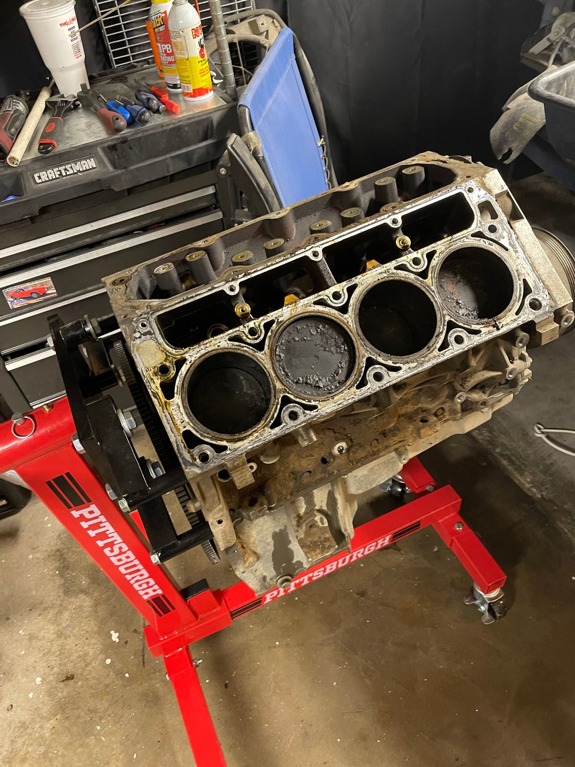

Only have pics before the sanding. Everything is at machine shop now.
Before cleaning
After cleaning and before sanding
