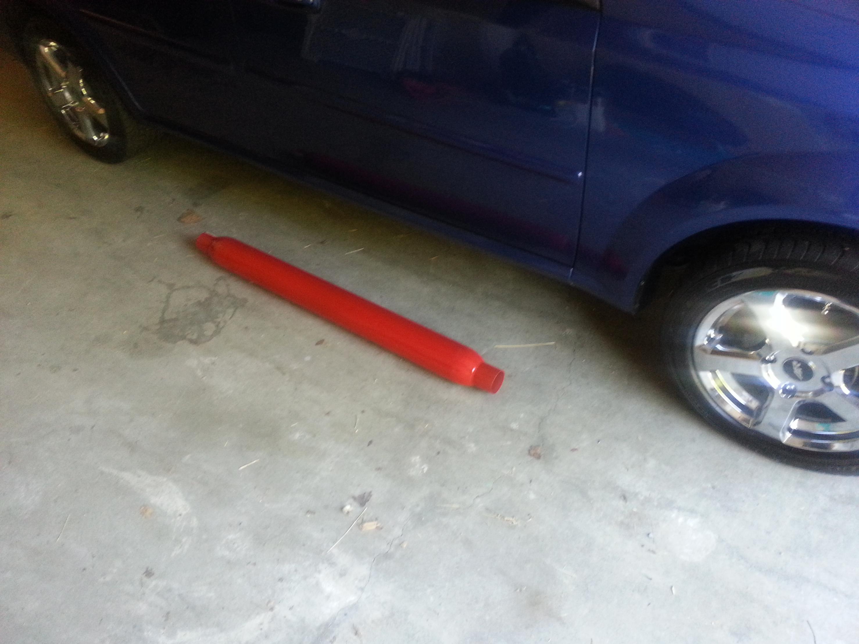

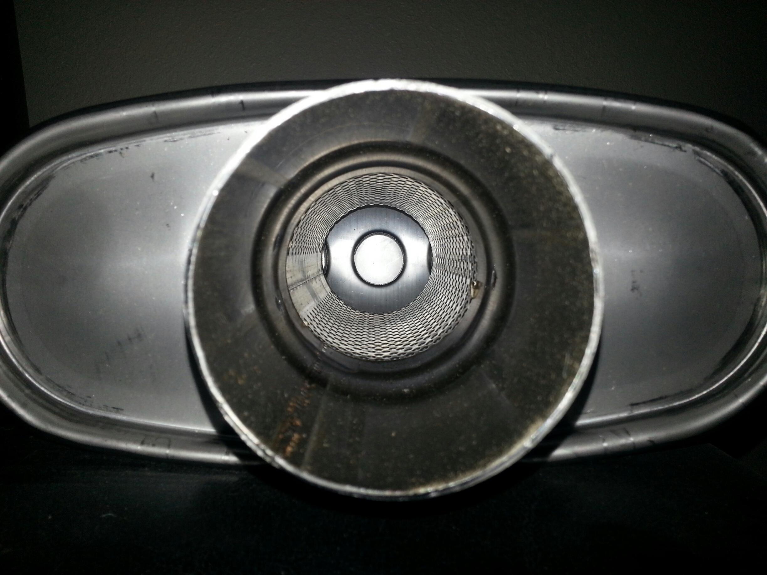

Unless you're racing and should be using straight pipes, Always replace the
resonator(s)/inline muffler(s) with the longest(or two or four smaller) Thrush glass pack you can fit under. This will change the mid-range drone into a deep growl when using aftermarket performance mufflers. Used with more restrictive OE type mufflers, it will be quieter @ cruise while still having a better growl when floored. Walker/Tenneco owns both Dynomax and Thrush. They were contracted to make the first
"turbo" muffler for the '62-64 Chevrolet Corvair Monza Spyder. The Dynomax Super Turbo flows and sounds better(less "tin") using its flow directors than the Hush Thrush/Mad Red muffler, but usually costs $20 more. Yes, Thrush still has the original "turbo" design as well, but is more for sound effects(more "tin") and value because its below the Mad's construction. Speaking of sound effects, its been proven time and time again Flowmaster is for just that. I've used the Super 10s and Delta 50s, and they don't come close to the efficiency and tone of Dynomax, especially the Ultra Flo Wielded. But it all boils down to how you want your
vehicle to sound(deep vs high), I've just given you more tools.

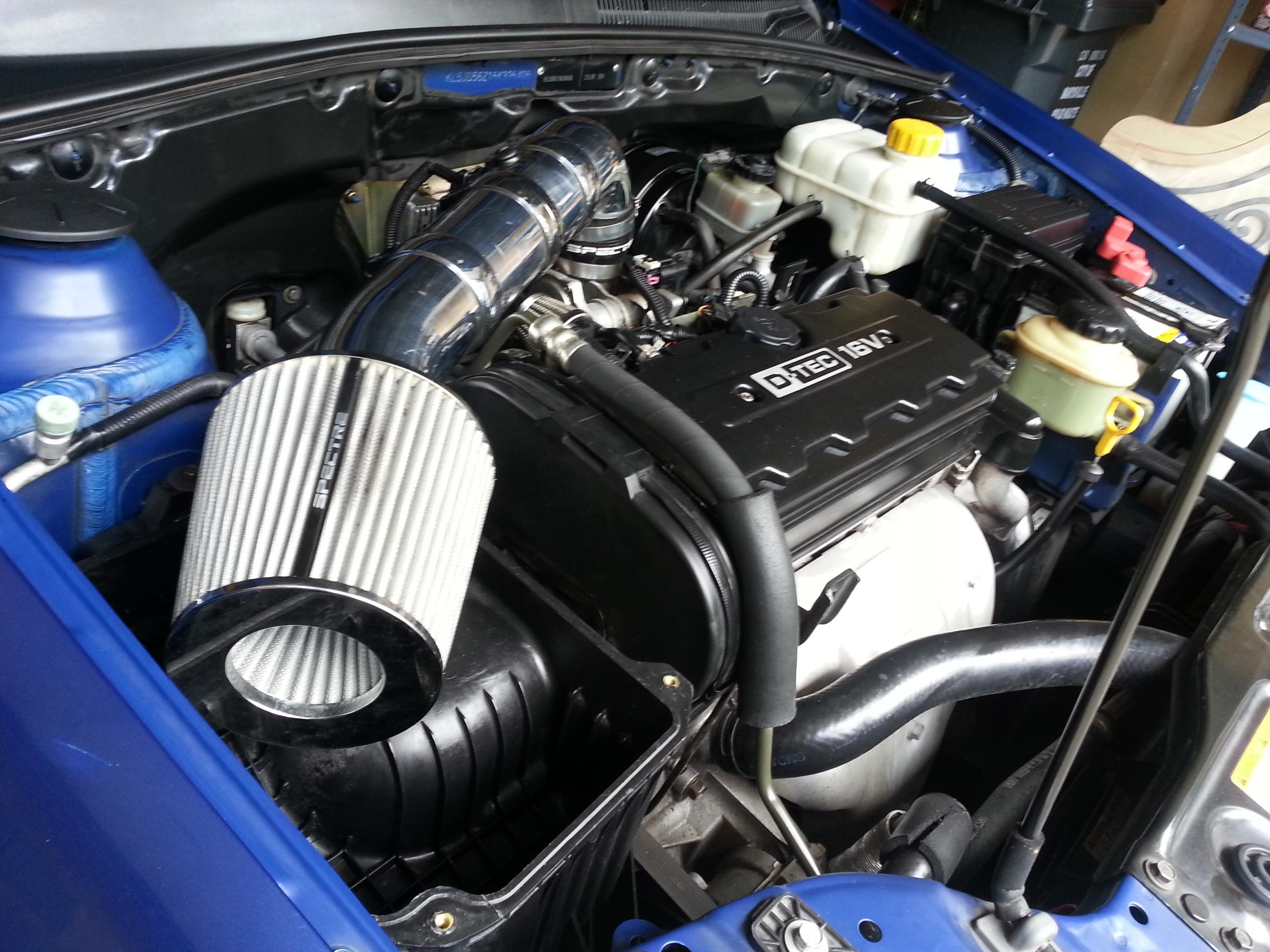

For value and creativity, you can't beat Spectre Performance - Air Filters, Cold Air Intakes & Automotive and Hot Rod Accessories. The filters are as good as K&N and you can design the intake tube(s) however you want. Plastic sections are usually available at most auto parts, while the tougher aluminum bits are on the site and in the bigger stores. To the "cold air" users: ever notice most Hornet racers strap the filter directly to the throttle body? I use the shortest ram I can for throttle response. Btw make sure, if you're using a short ram, that all old OEM intake pieces(resonators/silencers) are removed from inside the fender, etc. They are obstructions to the cone filter after all...
