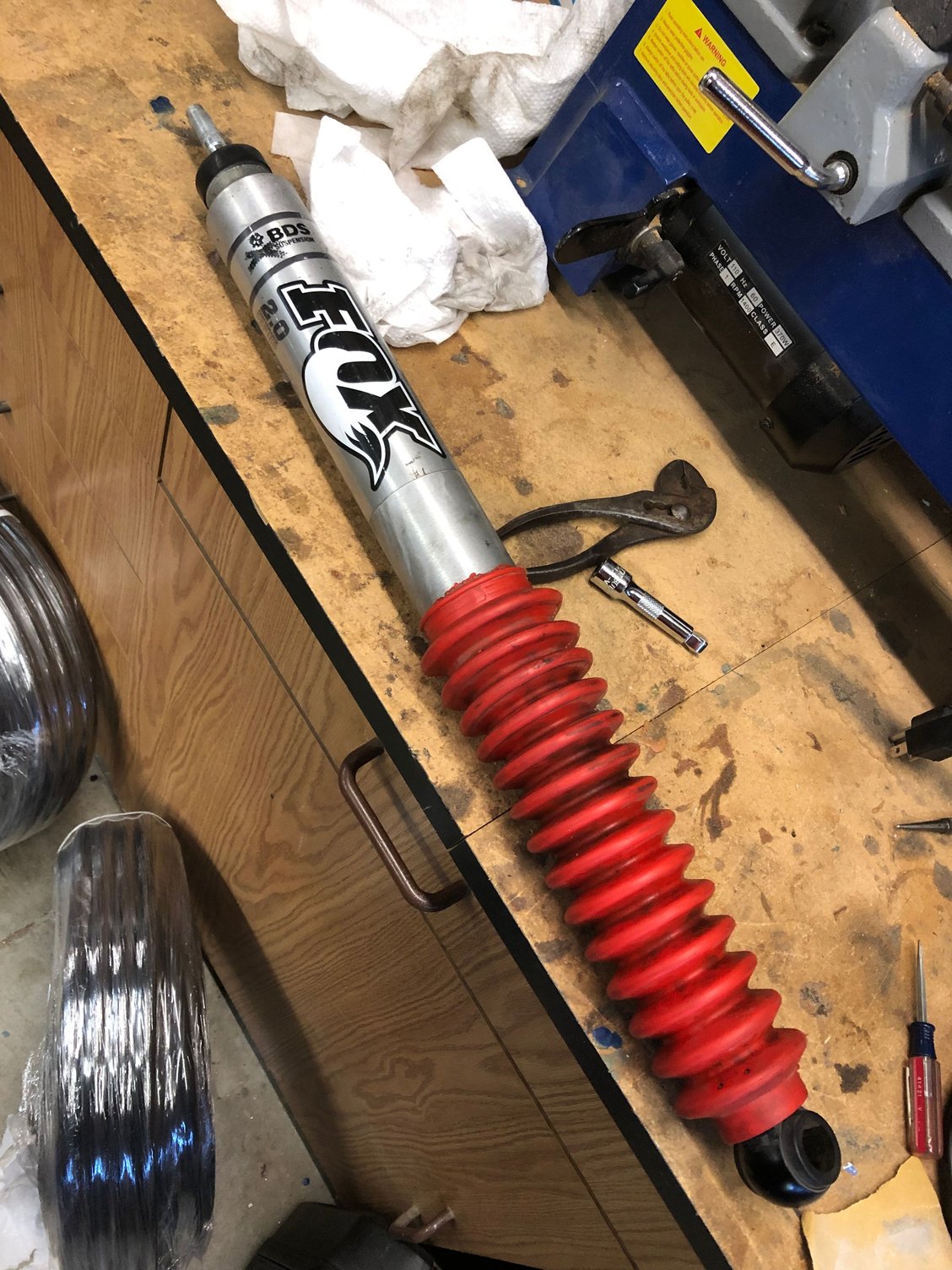

thats fox 2.0’s with a red rough country shaft boot. Ugly as **** but shaft protection is kinda nice. Can get their black ones for 10$ on ebay
