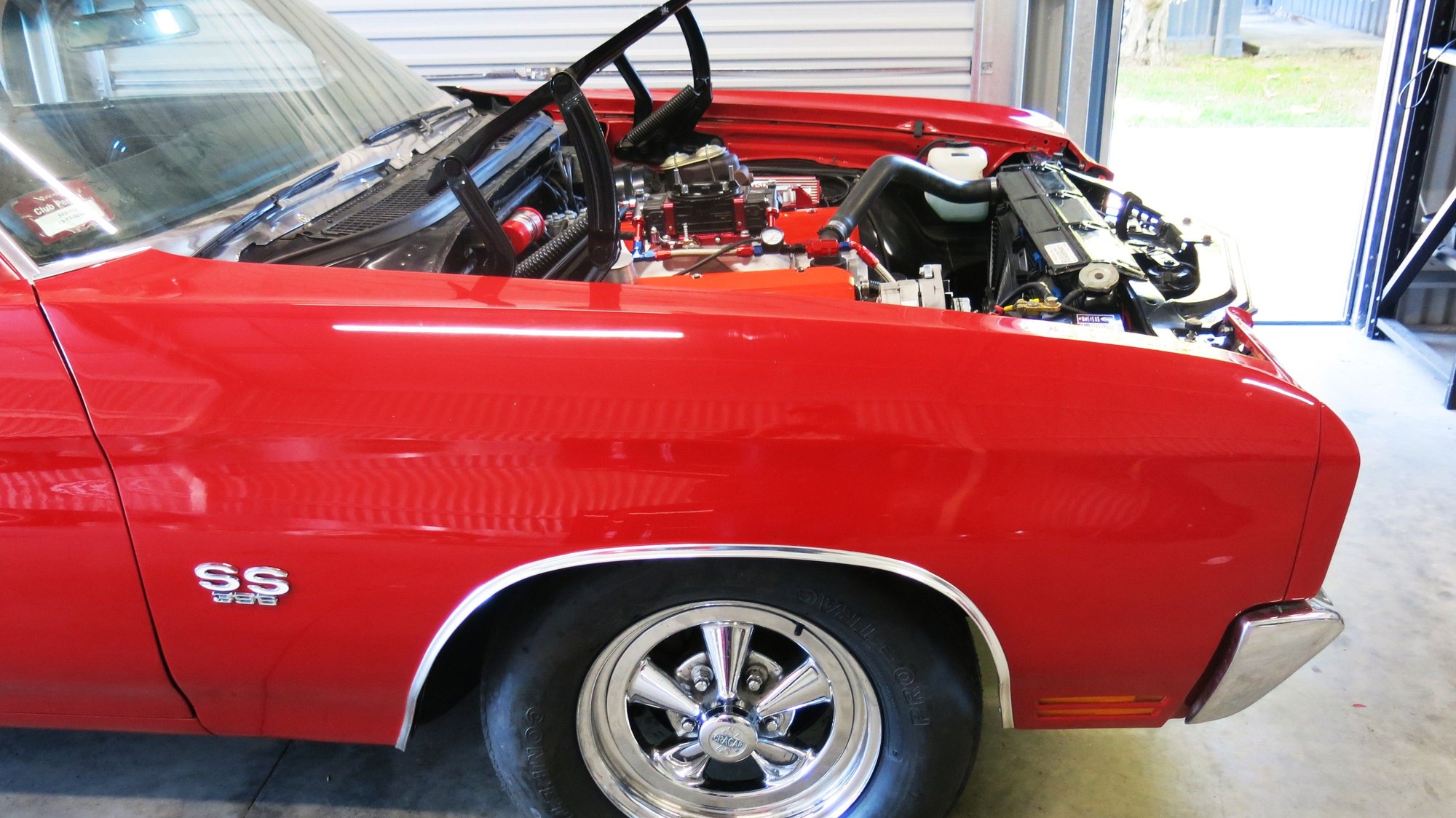

Looking for a discussion/help advice on a TCI trans I have fitted behind my blueprint Big Block engine .. This is a brand new build..10 miles at most .. it seems that when it gets up to temp the fluid comes out of breather on transmission in a big way.. seems to have to build pressure ? and the transmission is red hot as is the convertor..I mean as hot as the headers hot..somethings gone very wrong.. , a couple of suggestions from friends are that the convertor is locked up (Coen 2800) also thought it maybe over filled, its not.. or bands have locked together , car still has drive but did make a clunk and grind once when put into drive.. Ive tried to contact TCI with no response..
