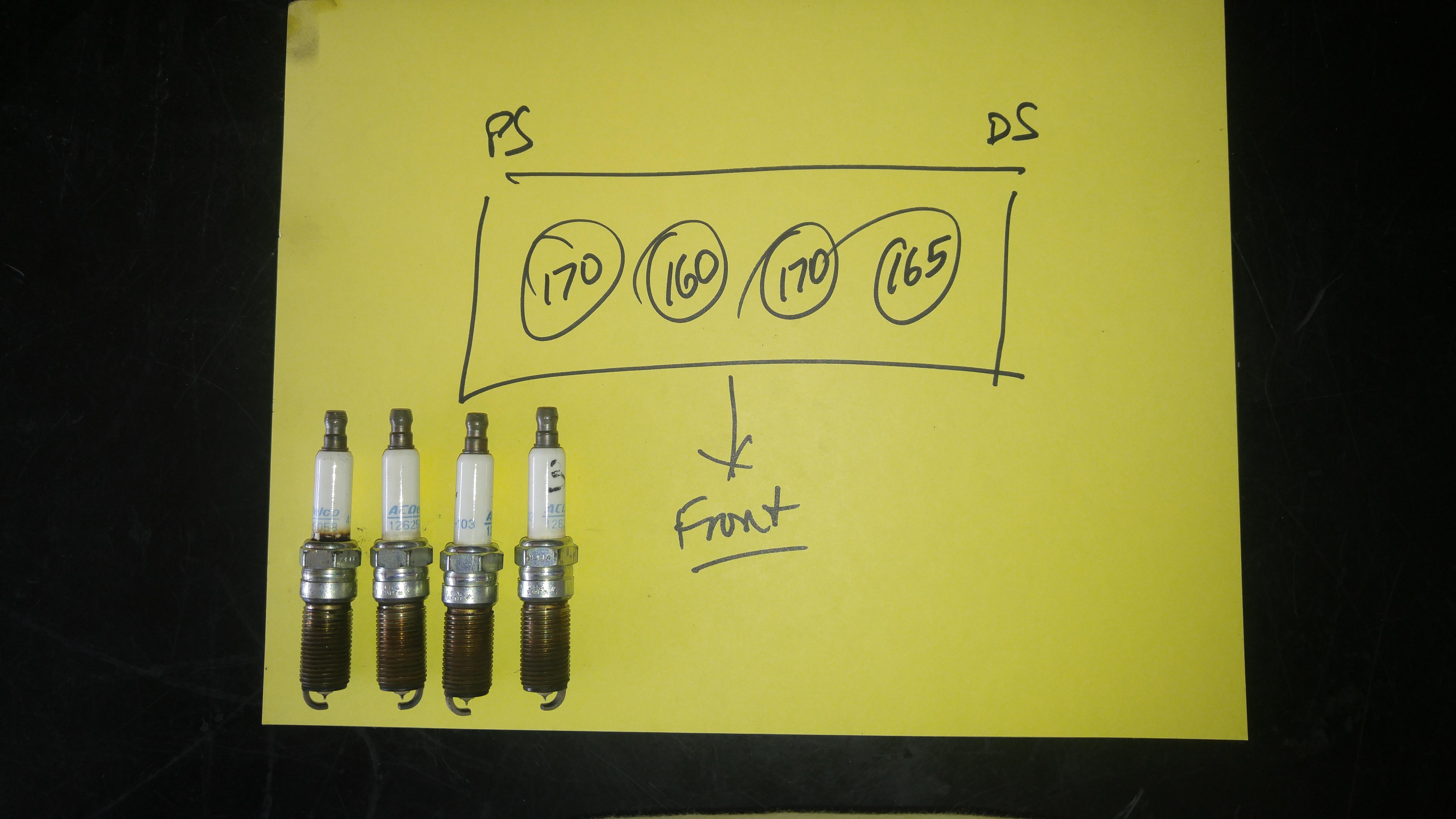

So far I have replaced the water pump, radiator, thermostat and temp sending unit. I compression tested the engine to see if there was a problem and that seemed to come back fine ( see attached photo ) Cyl 1 - 4 were 170,160,170 and 165 respectively.
