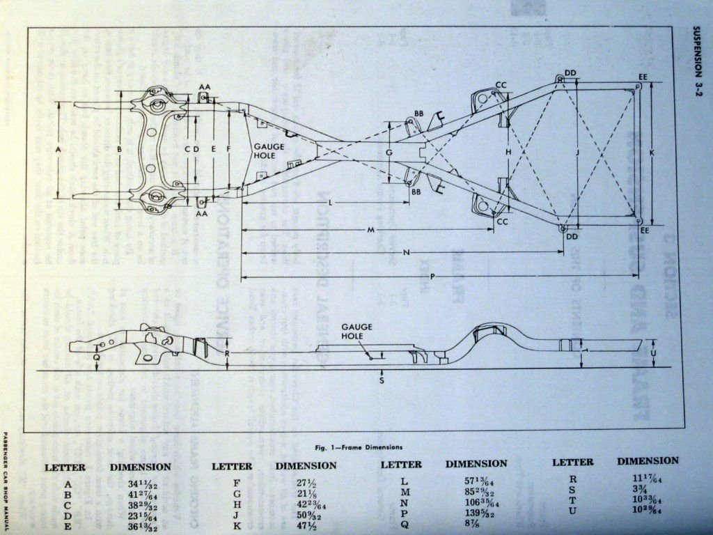

Hey, i was wondering if yall could help me with a problem? Me and my dad are rebuilding a 63 4dht impala, but the frame is rusted out and cannot be used. we have another frame that could fit... the main problem is that the original frame has like a drop between the front section and the middle were the 2 tubes meet. The frame that we want to switch it out with does not have the "dip", is it necessary? Ill add som pictures for better understanding. thx - greetings from Norway...
