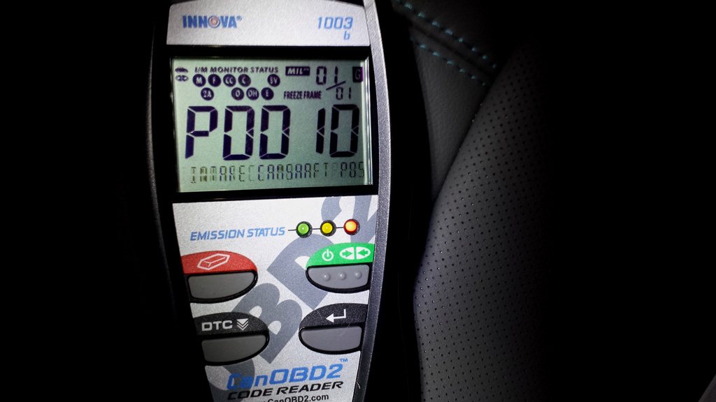

Anyways, found my OBD2 code reader and pulled the code. P0010.
P0010 Chevrolet Intake Camshaft Position Actuator Solenoid Control Circuit OBDII Engine Light Trouble Code | Engine-Codes.com
I did have to look up in the manual how to get to "accessories on" instead of a vehicle start.

Take it to the dealer there is an NHTSA recall for this problem.
found it.
ENGINE (PWS)
Date Reported
NOVEMBER 01 2013
NHTSA Reference
#10053905
TSB Reference
#PIP-5162
Description: GM:SOME VEHICLES MAY DISPLAY A MALFUNCTION ONDICATOR LAMP ILLUMINATION DUE TO DIAGNOSTIC TROUBLE CODES P0011 AND/OR P0014.CAMSHAFT SOLENOIDS MAY NEED TO BE REMOVED, INSPECT THE SCREENS FOR DEBRIS, AND CLEANED IF NECESSARY. ALSO INCLUDED MAK
