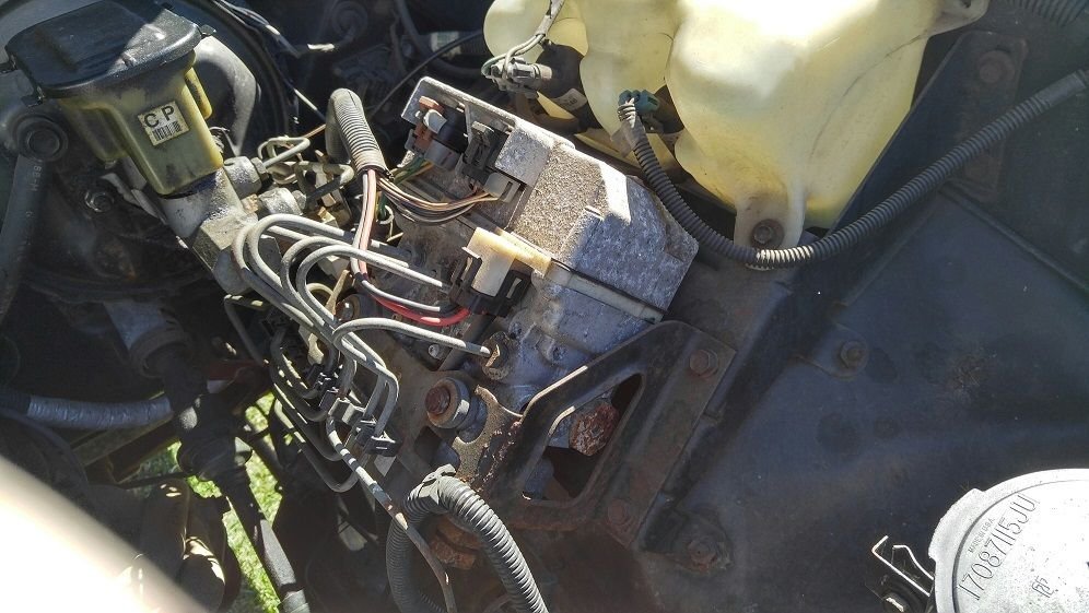

So I have traced the blockage to this but I am not sure what it is. I thought it was an ABS control modulator but when I look that up to see how much it costs it comes up with something different. Can anyone tell me for sure what the name of this is. I know that when i break the lines loose going into it from the master cylinder I get plenty of fluid pressure but when I break the line loose going from this box the right front brake caliper I get very little fluid pressure at all.

its the electronic brake control module and brake pressure modulator valve...also known as the abs module and pump.
any abs codes?
so when you check the l/f outlet from the pump, its good?

Yes so I checked the line coming out of the master cylinder going to that electronic brake control module and had plenty of fluid and then checked the line coming out the electronic brake control module going to my caliper and had very little fluid coming out.
No codes at all
Old Mar 11, 2017 | 11:34 PM
with a scan tool, do a abs pump autobleed procedure
