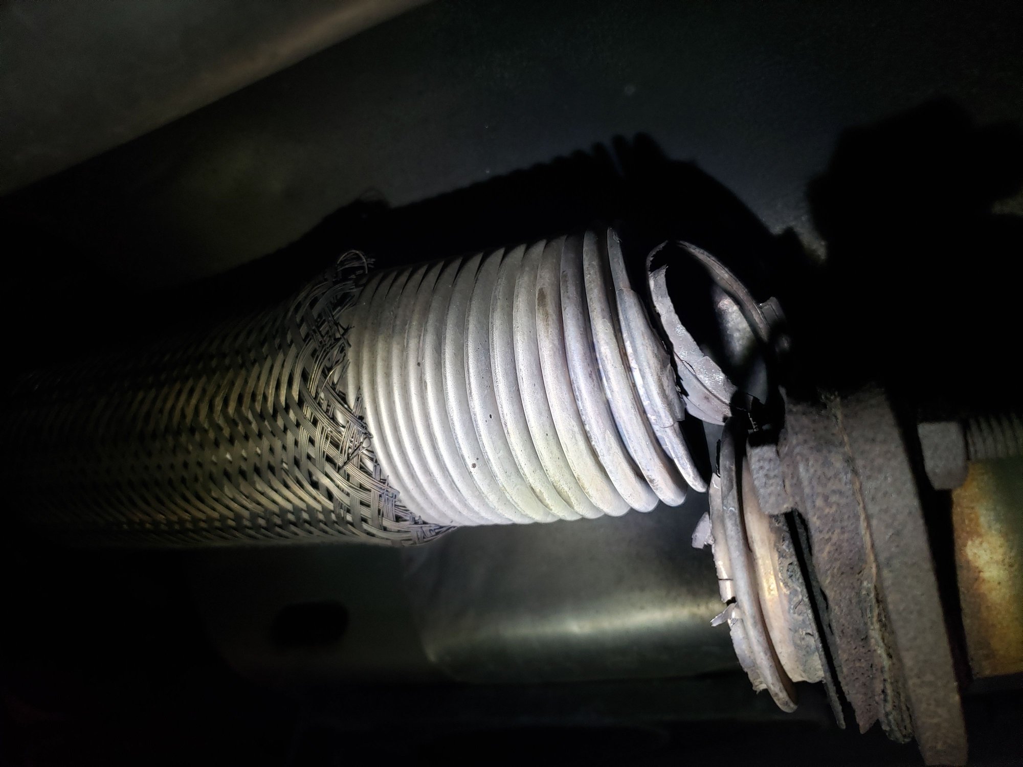

Hey everyone, this is my first time posting here and I'm hoping for a bit of insight/advice. Like I said in the title, I have a 2006 Chevy Malibu LT. Earlier this year, I got a crack in my exhaust pipe repaired for around $250- see attached image. I mainly got this fixed since it was incredibly loud and obnoxious, and I was extremely happy with how quiet it ran after that.

Here's the busted flex pipe. Not 100% relevant to my post but I thought it was interesting.
