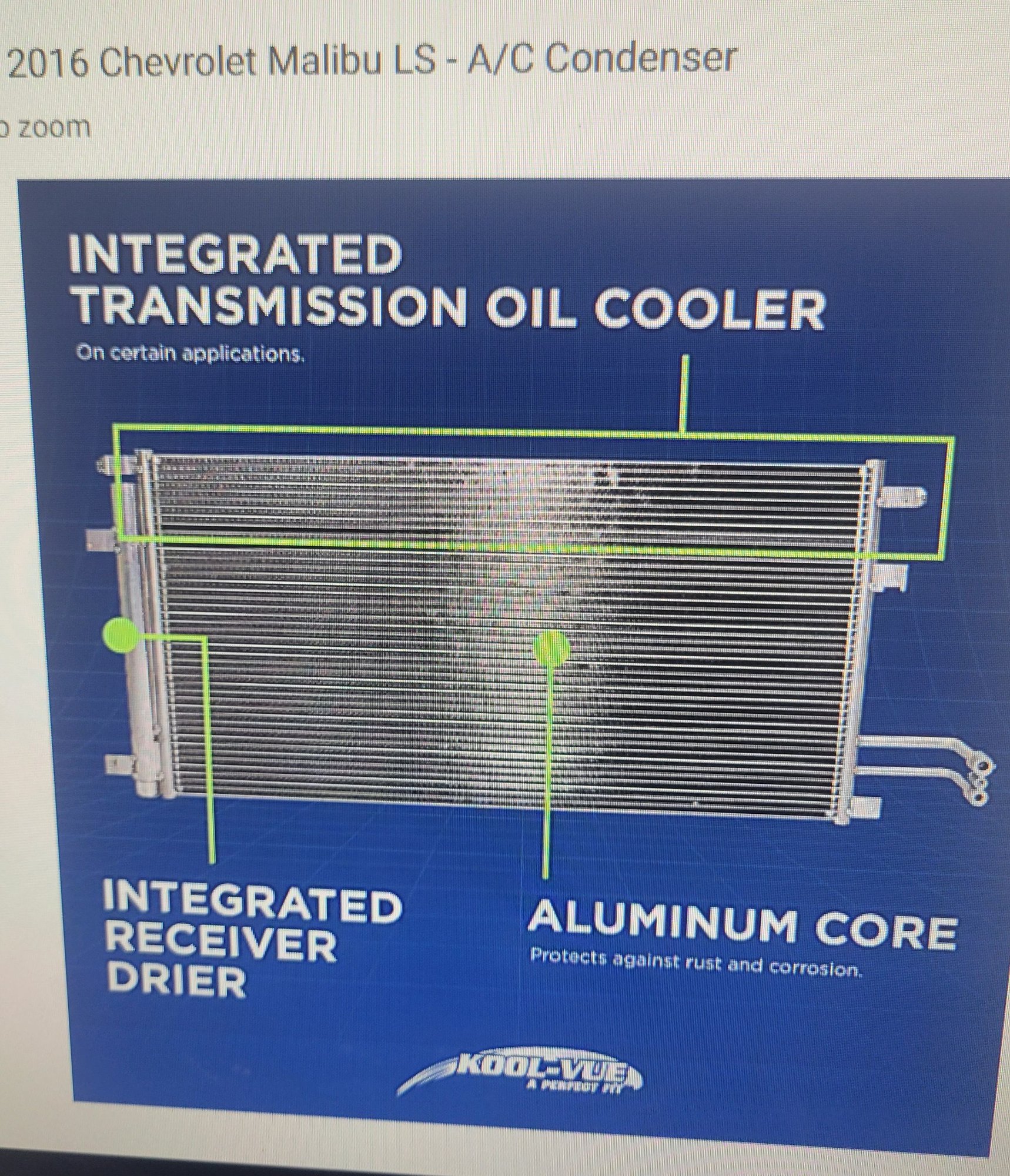

Does anyone know the Location of AC Drier on a 2016 Chevrolet Malibu LS 1.5L? I bought a Dessicant kit but the Mechanic says he cannot find the dryer. It is not on the firewall and not after the condenser. Does anyone have a photo of where this Dessicant kit is supposed to go. Thanks in advance, your help is greatly appreciated.

On the Driver side of the AC Condenser, there is a tube attached to the condenser. I hope this helps
2016 Chevrolet Malibu LS 1.5L OEM Condenser with Intergrated Receiver Drier
