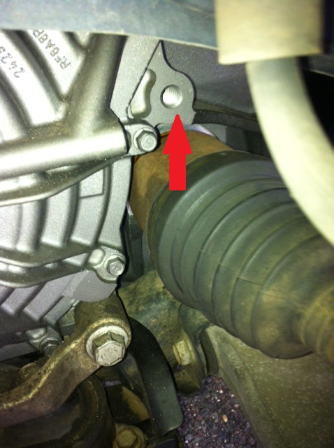

Hello Guys,
I recently had my transmission replaced on my 08 3.6 LTZ, It looks to me like they forgot to put a bolt in ?? I have a picture...Can anyone confirm if a bolt should be in this spot or not? Thank You I took the picture from the left wheel well..

Is there a hole in the motor? or does it flatten against the motor?

I am not sure I didn't look that far into the hole, I just saw that and saw it was threaded. I cant really get my head into there to look.

At first I thought to myself "Why would they put it there if it wasn't meant to have a bolt in it." But then I released that this transmission probably goes into other cars as well that have different set-ups.
True.
Can you put a pencil in there and measure?
If it goes father in than the casing, then there's probably a bolt missing.
Even some stiff bailing wire would work.

omg....that is the jesus bolt.
