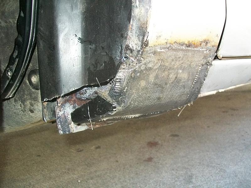

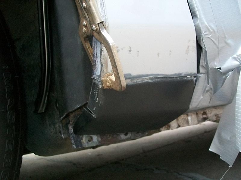

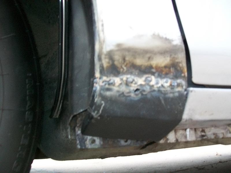

Hi..... Thanks.... and yes, you are right, but this is not exactly the situation where I would replace the entire fender..... The fender, itself, is perfect except for the bottom two/three inches where it attaches to the bottom of the car and it does NOT show even now.... I inspected it again today and if I cut off another inch, I can use a flange tool to manufacture/fabricate a small patch panel, and attach it with a clamp or two to fit it perfectly, glue it, and then a few days later, weld the seam and grind..... and use touch up paint which I already own.... and yes too, I restored a 1927 Chevy basket case where I used the same technique fabricating my own patch panels....
I was also very tired the day I wrote this as I asked about head gasket replacement, when later I realized my mistake and of course, it is "intake gasket" replacement... I wrote to about 20 different outfits, from Craigs List mechanics to Oreilly approved repair shops to Chevy dealers..... the only thing they have in common so far, is that they all know what a car is.... and don't agree on much after.
Thanks again for the lead... I will save the link and if I decide to replace the fender, I will use it. But if I do, it is more than the cost of the fender... it also costs quite a bit to paint that new fender.... We did have a professional estimate for replacement about three months ago, and they wanted over $1000 ..... my patch? Well, the cost of the metal ($5) and a rattle can.....

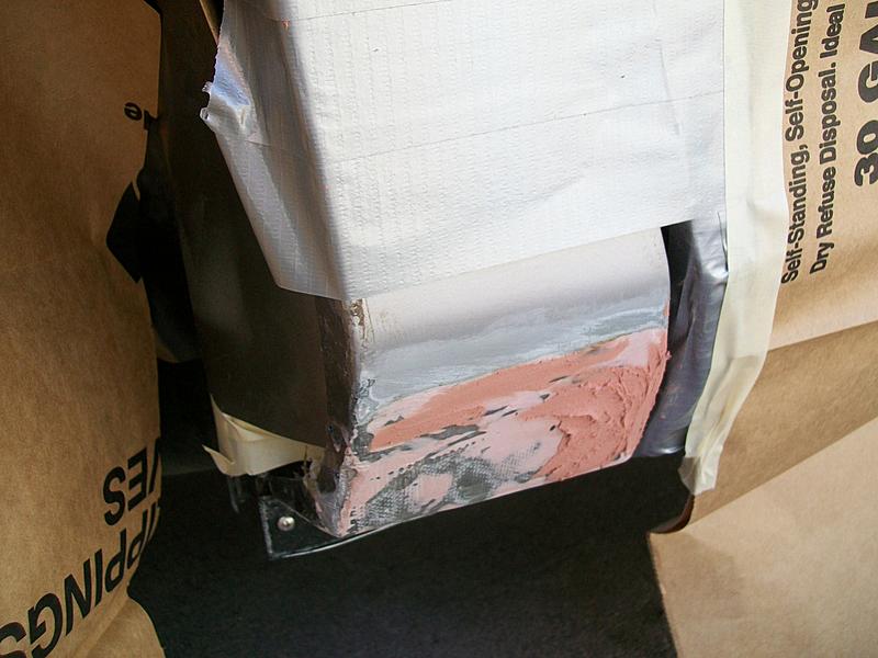

Finished the process and learned a lot.... The rattle can paint I bought for it, that was supposed to be OEM was defective... so I used a high density roller system to apply that paint... I have used this method before... I did clear coat it when I was done, but may go back with some decent spray pain and re-do it... but for now, it came out acceptable...

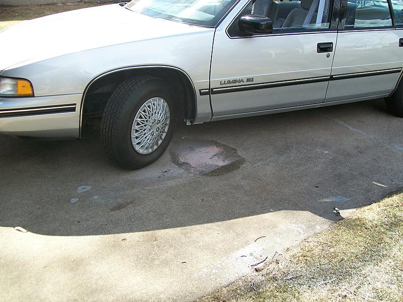

My next problem.... I would like to add mud guards to the front wheel wells too, but notice, there is a molding around the wheel well.... I have some Chevy generic mud guards.... and I thought I would use them but see no way to install them without cutting the extensive molding on this... and then mounting them to the metal fender flare... Has anybody found a set of mud guards designed to use on a Lumina and yet, keeping the molding trim around the wheel well? I even googled 1990 Luminas hoping to see one with mud guards..... no luck....
Suggestions?
