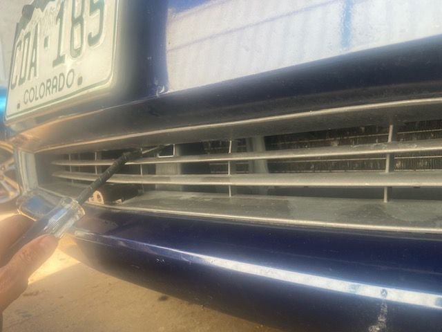

Access and release the nylon retaining head of the 3 bumper cover forward bottom retainers, removal tool can access through the front of the lower bottom grill.

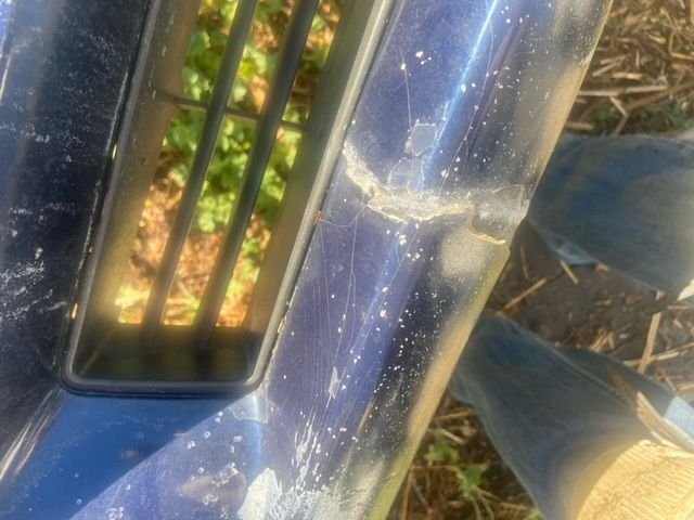

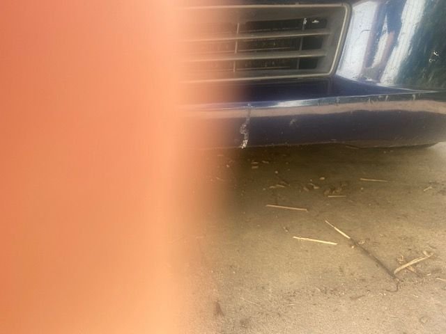

After repair (I didn't take a pic of before repair but this split were bad/big, like the cover was going to split in two)
Access to release the 3 main retainer nylon round head plugs-pull down:

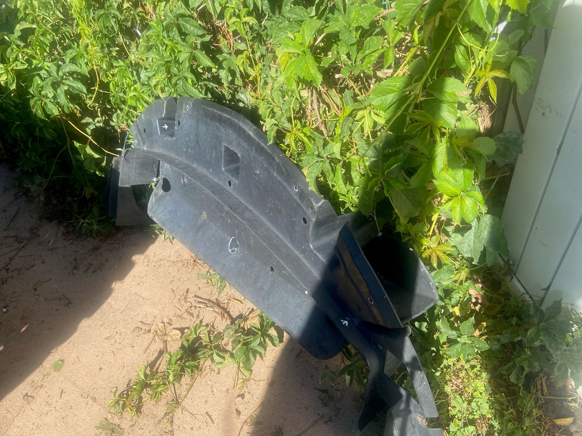

Air ram retainers:

Reinstalled, cracks repaired, strong now:
The worst crack/split repaired, still a bit ugly but strong now(if I find a dark blue paint pen, I'll paint over it to help hide some):
Air ram removed (one of the air directors partially visible):
