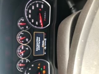

After remote start:
four messages:
Service ESC
Service Trailer Brake
Brake System Failure - 62 MPH Top Speed
Steering Assist Reduced Drive with care
Lights on dash that were illuminated
ABS
Check Engine
BRAKE
Traction Control
Truck is a 2019 Silverado
engine light on as well
called dealer, taking in for service
called Onstar, they said showing all systems have failed
several Chevy and GM owners reporting same on
gm-trucks.com

Dealer has TSB for codes.
They are updating software now.

This just happened to me on Saturday with my 2021 Suburban. I have 43,000 miles. Hope it isn't a big deal!
