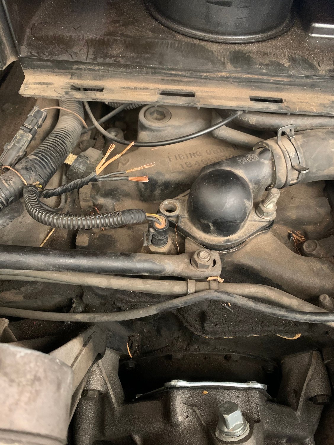

I was trying to change my thermostat and I did but there were wires connected to the bolt and I was taking the bolt off the wires ripped off. I’m trying to ask what can I do to fix this problem.its a Chevy caprice classic 1991

you're posting in the wrong section. It says "not for help threads" in the title.
Anyway they look like grounds. You'll need to find a ring terminal that fits on the bolt and crimp those wire back into it. For now to get moving you can just pinch them under the bolt head.
