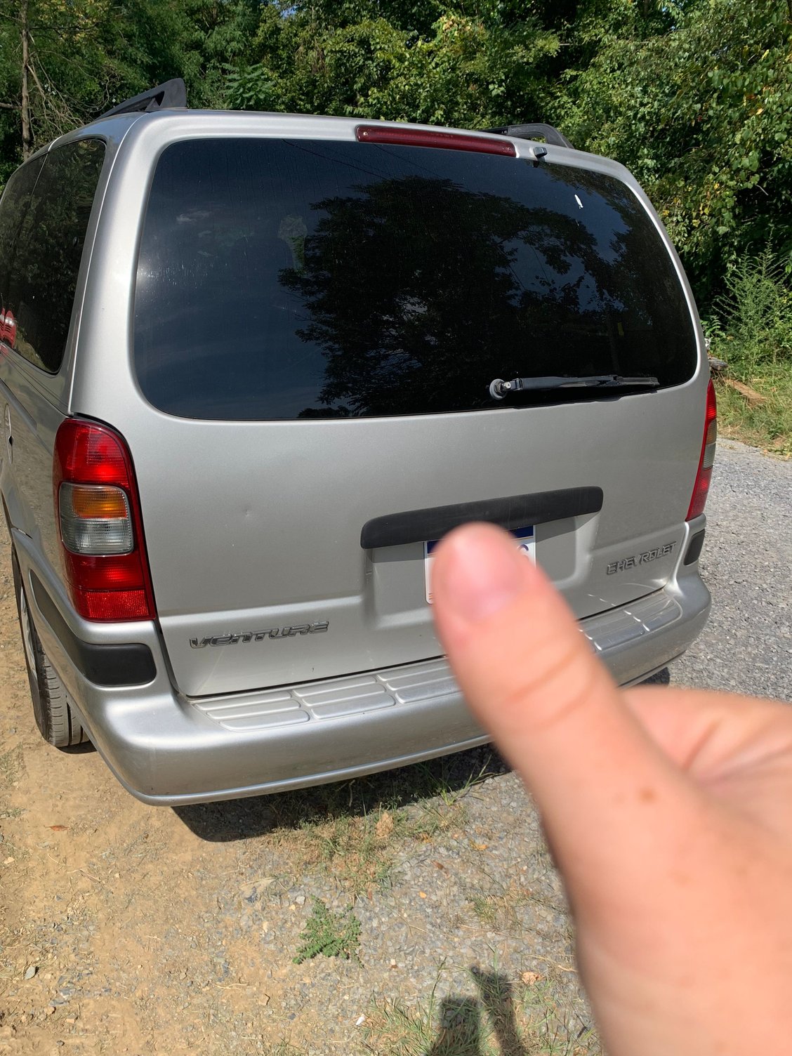

Left turn signal doesn’t work in the back & blinks fast in the front & the right turn signal cuts in & out, gas gauge doesn’t work. It drives great, just don’t know how to fix the problems. It has a brand new battery, brand new brakes (just needs put on) & has headlight cleaner cause even with driving with brights on at night I can still barely see

Looks like it is in good condition and you got it at a good price. Check your left rear turn signal bulb. It is either bad or bad socket or wiring. The right turn signal is also a problem with the wiring. When you say that the fuel gauge doesn't work, is it erratic or nothing at all? If it is erratic then it is probably the stepper motor in the gauge. If it doesn't work at all it is likely a problem with the sending unit in the fuel pump.

I changed the bulb but that wasn’t it. About the gas gauge, when it 1st starts up it goes to full but after driving it for a few minutes it shoots down to e & stays there & every now & then it will kinda float up a little

Check the socket for the bulb and the wiring to the socket as well. It still could be either the stepper motor or the fuel sending unit. In the years that your van was built, GM had trouble with the stepper motors going bad.
